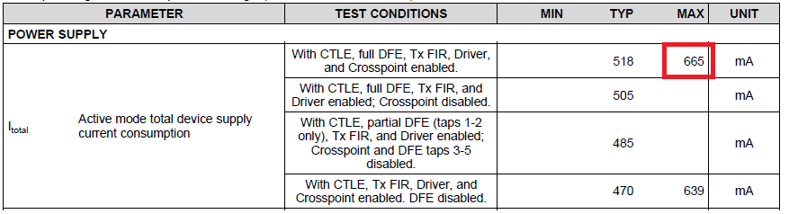

From the datasheet mentioned as below, the worse (max) case power consumption is 2.5V x 0.665A = 1.66W, Right?
  • Anne,
    4 * Wchannel + Wstatic_total= Total Power Consumption.
    Please see the table below.
    Typical = 241 mW  * 4 + 329 mW = 1293 mW. Use this number for thermal
    Worst Case = 430 mW * 4 + 525 mW = 2245 mW. Use this number for DC-DC regulator selection
