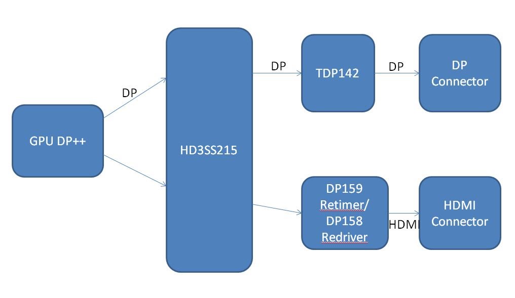

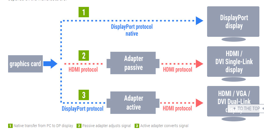

Customer want to add a DP redriver between their GPU and DP connector.
As shown below (quoted from https://www.delock.de/infothek/DisplayPort/displayport_e.html), the GPU have 3 different modes and the DP redriver need to support all cases on the same board. The major concern now is for case2. For case2, the output of GPU is AC-coupled signal with HDMI protocol. My question is, can we use a DP redriver (e.g. TUSB546) to support case2? If the answer is positive, please tell us how should we connect the HDMI clock (routed on 4th lane of DP?) And how should we connect DCD signals with TUSB546? THanks!
