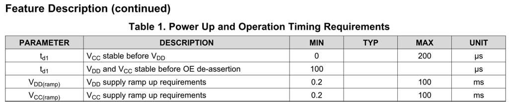

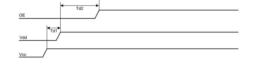

I have one question about Td1 at TDP158 datasheet. In the table 1, we could see the ramp timing of VCC and VDD is between 0.2 to 100ms. And the stable Vdd should wait for Td1 after stable VCC. But the Td1 timing (0 to 0.2ms) is very short and it is hard to meet spec. Is the unit typo? Thank you.
