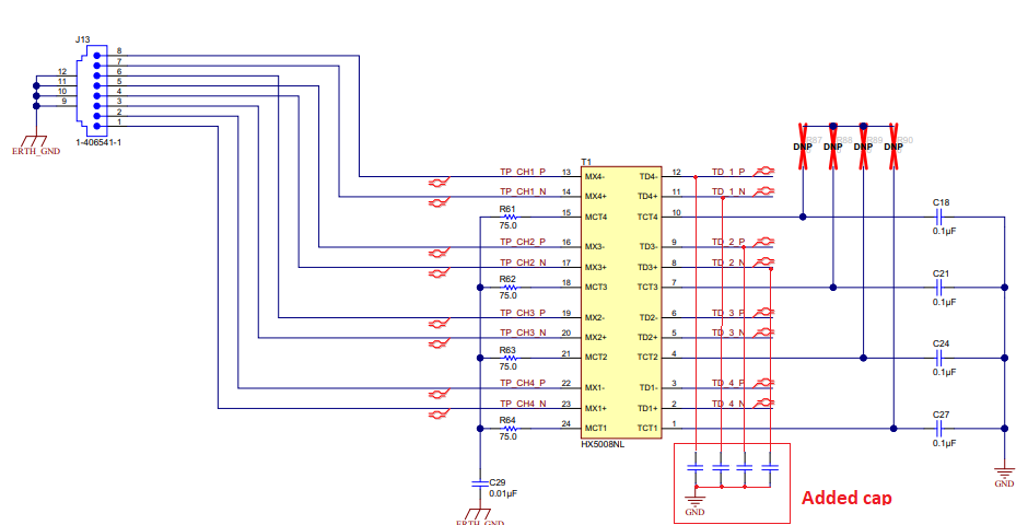

This time I use DP83867ERGZ-R-EVB (48-pin package) board and EVB-KSZ9897 board. They both work fine at 1Gbit with any external router I have through long (about 2 meters) and short (1 meters) cables. EVB-KSZ9897 even works fine with ZCU102 which have DP83867IR in 64-pin package. When I connect DP83867ERGZ-R-EVB and EVB-KSZ9897 together 1 Gbit connection established after 1 to 5 minutes with short cable and don't established with long cable within 5 minutes. Is it some sort of incompatibility between KSZ9896/KSZ9897 and DP83867IR in 48-pin package?

  • Hi Sergey,
    Could you add 10-15pF caps from signal to GND on each of the MDI lines and let us know if this helps improve the link-up time with short cable?
  • Hi Ross,
    I added 15pF capacitors. Link-up time didn't improve after adding the capacitors, it even got worse. It still works with a long cable, but even with bit 9 in register 0x1E 1 Gbit connection don't establish with a short cable. There is my board and schematic with added capacitors.

    We also tried to implement capacitive coupling according to section 2.6 of DP83867ERGZ EVM User's Guide, it seems DP83867ERGZ board works much better in that case: link-up time is about 0 to 10 seconds with short cable.
