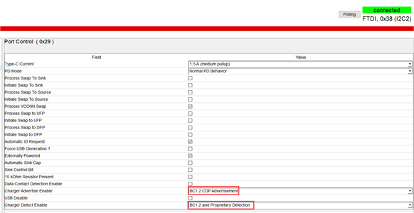

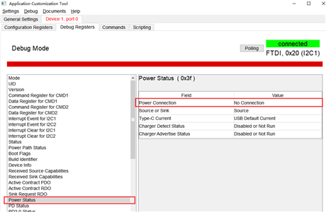

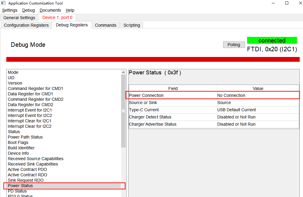

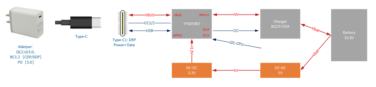

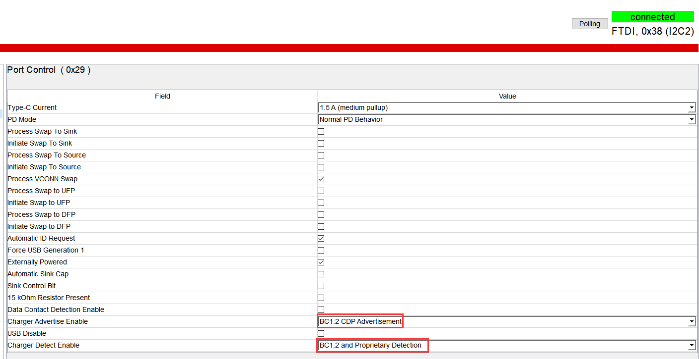

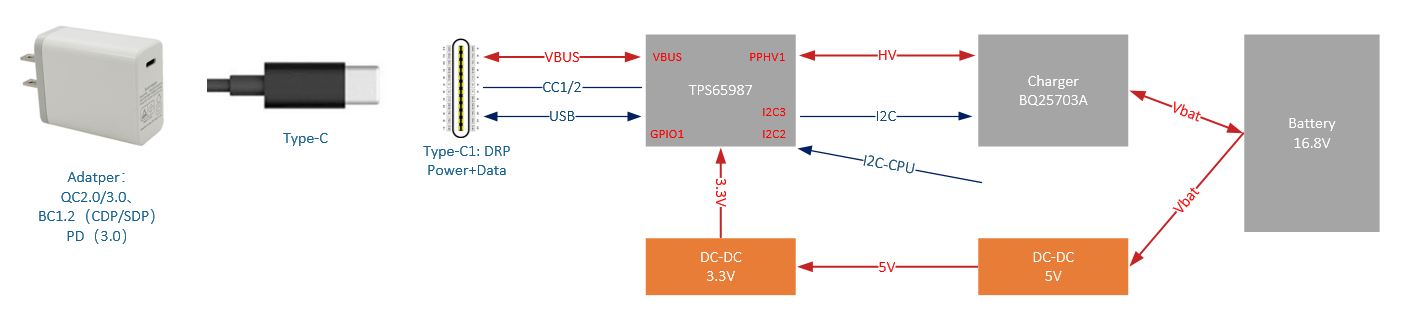

TPS65987DDJ: How to enable BC1.2 and QC2.0/3.0 negotiation of TPS65987DDJ?
Part Number: TPS65987DDJ
Other Parts Discussed in Thread: BQ25703A, TPS65987D
I have used BQ25703A as the charger controller of my system,can i set the proper input current of BQ25703A after TPS65987DDJ negotiated BC1.2 and QC2.0/3.0 with adapter ?
