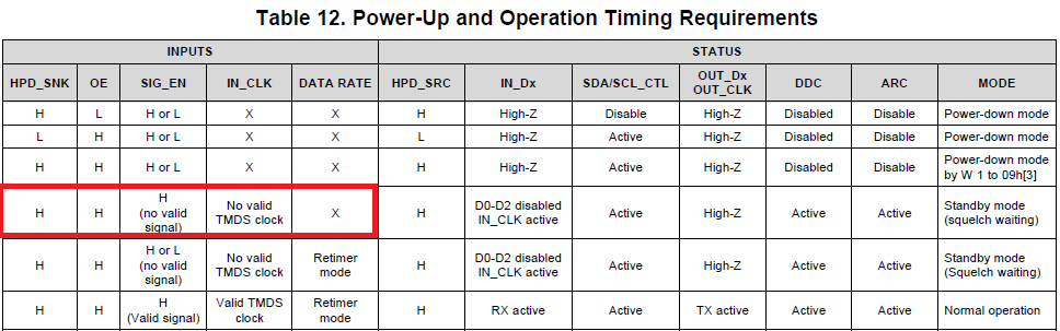

Following below configure of red mark; cusotmer found TMDS181 have 2 kinds power consumption situations.
1. Cable plugged, PC enter “Sleep” or CHROMA pattern not present HDMI signal. I measure consumption current of TMDS181’s 3.3V (include VDD 1.2V)
 In this situation, the power consumption will reach 46mA
2. Take of HDMI cable: the power consumption will only 4.7mA
The TMDS181 standby power consumption is too much.

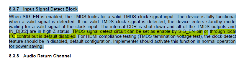

d/s shows that SIG_EN pin can be config by strap pin or I2C.
3. One more question regarding VIH voltage. customer follow TI reference design to use 62Kohm which is near to 65Kohm pull high to 3.3V. customer measure SIG_EN pin voltage, the voltage reduce to 2.5V. could you please provide comment for this?

    1. Please refer to section 6.5 of the TMDS181 datasheet for the signal condition in standby mode. Does the clock get turned off by the PC in standby mode?

    3. The VIL, VIH, and VIM are based upon a microcontroller driving the control pins. The pullup/pulldown/floating resistor configuration will set the
    internal bias to the proper voltage level which will not match the VIL, VIH, and VIM voltage in the datasheet.

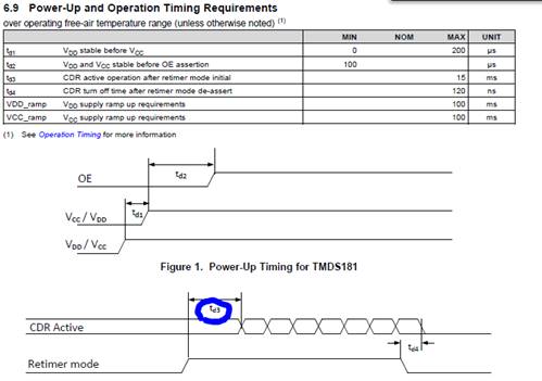

    thanks for detail. Could you describe how to make sure td3?
    On the DDC, please have TMDS181 unused SDA_SRC and SCL_SRC pulled to GND.
    => if those pin are floating, what impact for this situations?

    Td3 is an internal timing, it shows that once the retimer mode is enabled, it takes max of 15ms for the CDR to be active.
