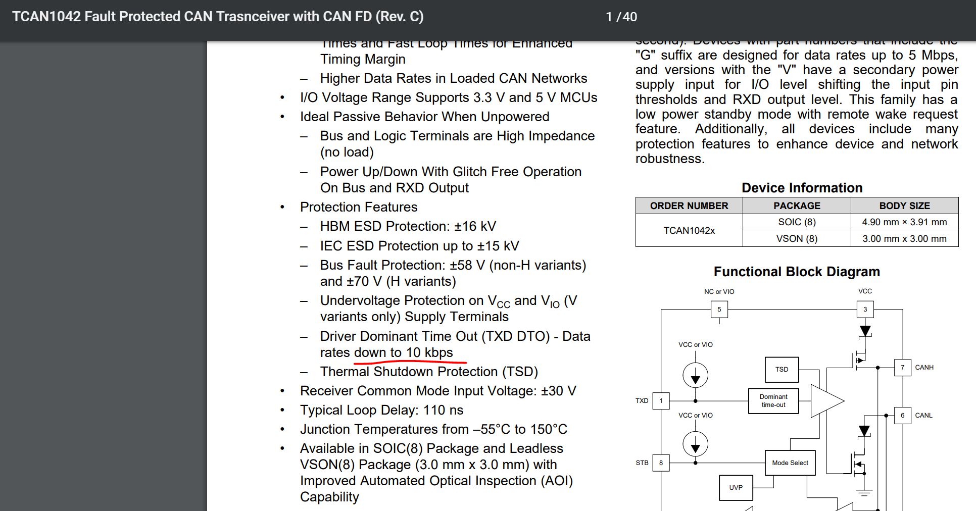

    I saw TCAN1042 datasheet but found it the Data rates only down to 10 kbps but customer need 5 kbps, shown in below pic1.

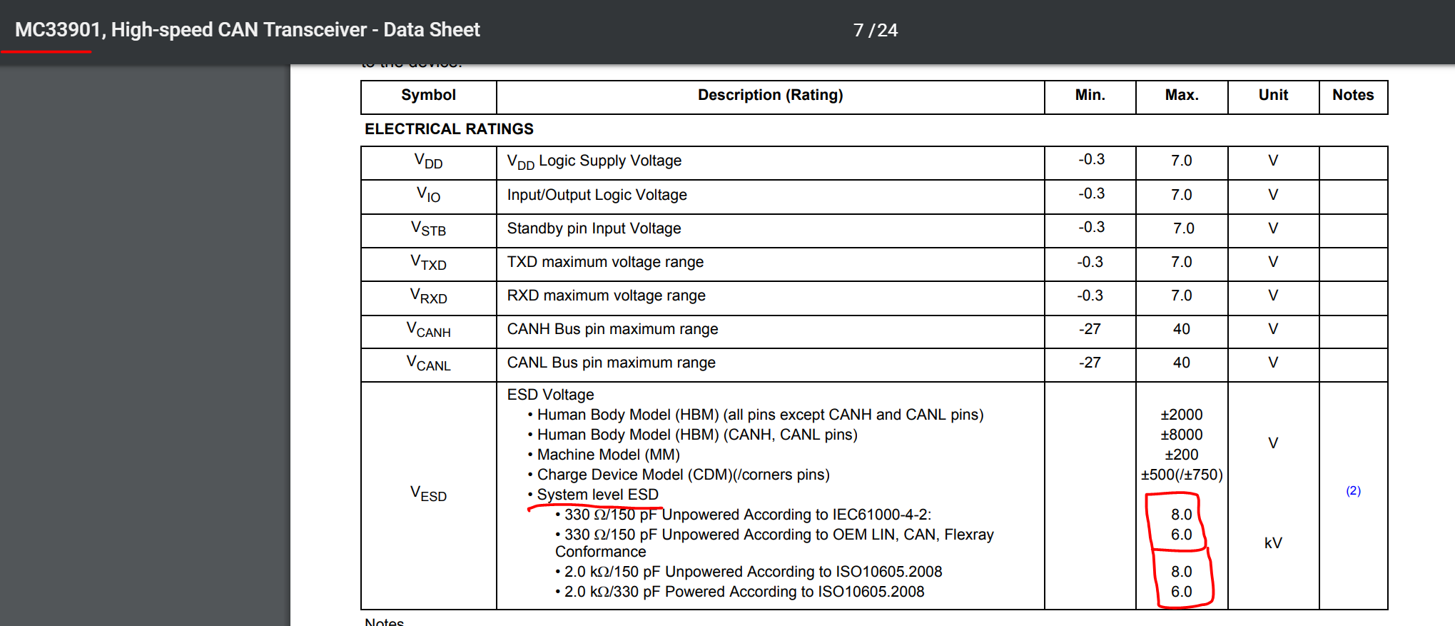

    The MC33901 datasheet shown ESD in below pic2.

    Yes, just verifying that you were looking at IEC 61000-4-2 and not IEC 61000-4-4. Unfortunately, we don't have any devices that have the IEC ESD requirement AND the low data-rate capability. With dominant timeout, all of our newer CAN transceivers can't transmit lower than 10kbps.
    Can the customer raise their data rate to 10kbps or higher? If they can, the TCAN1042 is a great candidate, with higher ESD protection relative to the MC33901. What kind of application requires that slow of a CAN bus?
