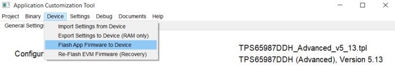

  • HI Oliver, many thanks for your reply, I tried what you said unfortunately no image- I should say though- I am not sure about steps 4 5 6, I can select th software as per 4, then step 5 connect the barrel jack and the FTDI port, but what do you press on the GUI to flash the device.?
  • Alan,
    About step 4, Just make sure we have the same project file on the GUI.
    Step 5 is to power up the PD controller; FTDI(micro USB) connect GUI and PD controller.
    Step 6 is to flash the bin file into the external Flash. PD has to be reset to load the new bin file from the flash.
    Would you please test the setup first I mentioned? Don't use any conversion adapter, that may cause more signal lost. Let's stick with DP signal only first. DP source and DP sink will help.
