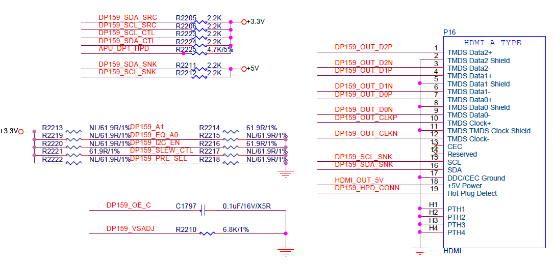

for AMD FP4 Type3 GX-215JJ ,PDG suggestion TI SN65DP159 solution , we need double confirm schematic and some question:
1. SNDP159 was can use HDMI to HDM? in our design is DP to HDMI but some question as below:
2.DP AUX Pin from CPU to SN65DP159 was need series cap?
3. about HDMI output, we just reserved chock or need series cap or need add level shift?
4. I2C Bus address and strap pin we need clarify( EQ_SEL pin was address pin, so need to setting FIXEQ at 7.5db or 14db) how to setting? currently I2C default we setting disable.
below as schematic
2.
3
If any suggestion, Please advise me.

    Thanks for your Reply. I checked your comments and bring up some more questions as below:

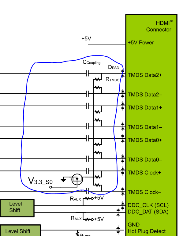

    1.a. For OE pin, I designed same as EVM which I place a 0.1uF cap on this pin. However, do we Need a serial resistors on TMDS path from SN65DP159 to HDMI sink connector? Please refer to Figure1.
    1.b. Followed above question, do we need to add a passive or active level shift on TMDS path? Please refer to Figure1.

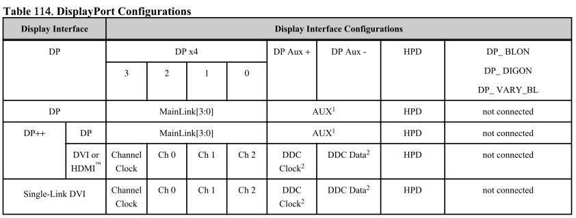

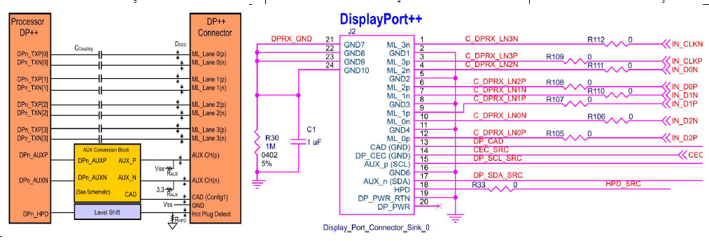

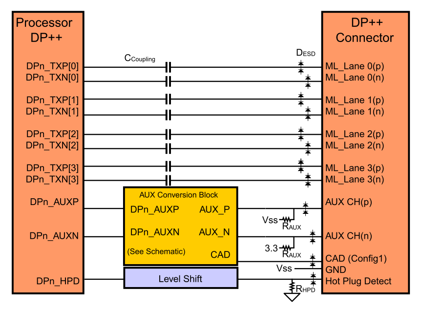

    2. I don't really understand about the sencod question you replyed. If we use DP as SN65DP159 Input, then there is no DDC bus in DP interface, but AUX interface.In this case, should we still connects AUX directly to HDMI connector DDC bus Pins?

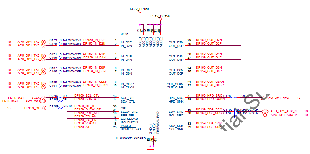

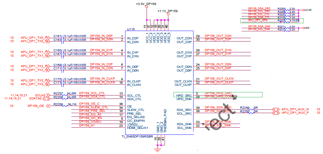

    3. Please refer to Figure2/ Figure3-1/ Figure3-2. If we design SN65DP159 on mother board, should we still need to use Level shift for HPD? Because it seems similar as AMD suggestion.
    4. AMD designed AUX and DDC bus in the same ball, it could be program either AUX or DDC.
    5. Is SN65DP159 the re-timer solution from DP to HDMI? Could we use AUX in SN65DP159 and Output to HDMI connector as DDC Bus?

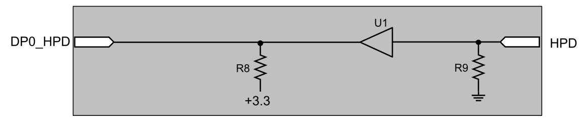

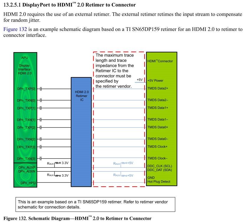

    Figure1: AC coupling caps for TMDS and Passive Level shift.

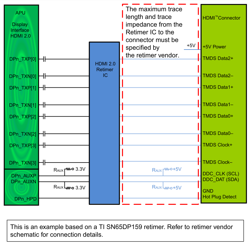

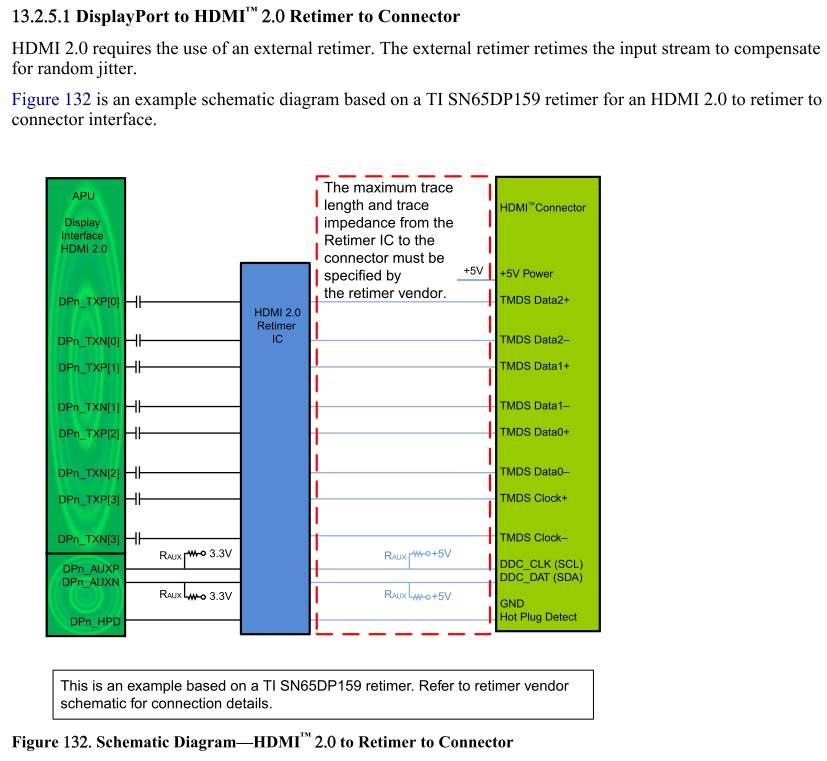

    Figure2: AMD schematic diagram demostration.
    Figure3-1: AMD eDP++ Connection
    Figure3-2 AMD HPD Level shift

    1a. When implementing the external capacitor on the OE pin, the size of the external capacitor depends on the power-up ramp of the VCC supply. You may need to tune the capacitance of this external capacitor since the power-up ramp time of your design will be different from the EVM design.
    1b. I don't fully understand this question. My understanding is that you are designing a DP++ to HDMI solution, the level shifting between DP++ and HDMI is already handled by the DP159. On the output of DP159 to HDMI connector, it will be DC coupled, but you want to place common mode chock on the clock and data lanes.
    3.  HPD on the connector side (HPD_SNK) can be 5V.
    3a. If AMD HPD is connected directly to the HPD of the connector, then from AMD recommendation, it looks like the AMD HPD is a 3.3V signal, so you need a level shifter to shift HPD from 5V down to 3.3V.
    3b. If HPD goes through the DP159 so the connection is AMD --- HPD_SRC --- DP159 --- HPD_SNK --- HDMI connector, then you don't need the level shifter since HPD_SRC is already a 3.3V signal.
    5a. The DP159 is not a DP to HDMI retimer solution, it is a DP++ to HDMI retimer solution.
    5b. DP159 supports I2C over AUX, so the connection will be AMD DP++ AUX --- AC coupled --- DP159 AUX --- DP159 DDC_SNK --- DC Coupled --- HDMI connector. On the connection between the DP159 DDC_SNK and the HDMI connector, please make sure you have pullup resistor on DDC_SNK signals.

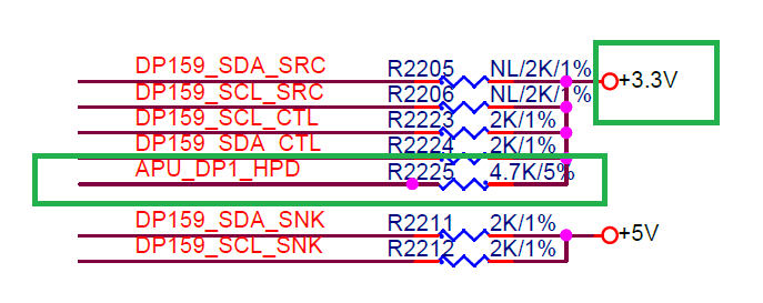

  • Hi, David
    We saw the SN65DP159 EVM about HPD_SRC pin pull up 1k to board 5V and we pull up 4.7k  to 3.3V(VCC), have any concern?
    If any, Please advise me.
    Lawrence.
  • Lawrence:
       HPD_src should be 5v .
    Brian
  • Hi, Brian
    If we use external connect HDMI, so R2225 should be Floating?
    current we design: CPU (HDMI2.0 TMDS)→ SN65DP159→ HDMI output (connector)
    Lawrence.
  • so CPU output is  DC coupled TMDS signal? DP159 input should be  DP++ signal or AC coupled TMDS signal
  • can you confirm?
  • Hi, Brian
     as we check AMD PDG, DDI Bus was can support TMDS, and PDG suggestion P/N is SN65DP159.

  • Lawrence
    1. You can have HPD from the connector connected to the HPD_SNK of the DP159, and then have the HPD_SRC of the DP159 connected to the AMD HPD signal. Or
    2. You can have HPD from the connector connected to the AMD HPD signal, and HPD_SNK of the DP159 connected to this direct connection between the AMD and the connector.
    For the #1 implementation, HPD_SRC of the DP159 is a 3.3V signal. Please check the AMD HPD input voltage requirement. If AMD HPD is a 5V signal, then you need to step up from 3.3V to 5V. If AMD HPD is a 3.3V signal, then it is a direct connection between the HPD_SRC of the DP159 to the AMD HPD.
