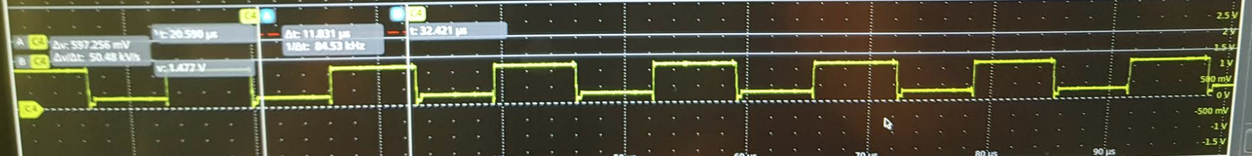

We are seeing some behavior with the chip that we are trying to characterize a bit more, but at a high level it seems to indicate that there is a random pulse being generated on the output side of the chip, which wasn't seen on the input.
-          Is there any functionality in the device itself, which, after de-skewing incoming signals (with the 2 clock delay), sends out a flag/equivalent start pulse to the output/host? This largely happens on lane 0 pins (1, 2, 23, 24)
-          Is it possible that the de-skew function is causing any unforeseen issues? Is there a way for us to turn it off, and purely use the chip as a re-driver?
-          Is it possible that because lane 0 is a special bi-directional lane for low-power mode, we have to terminate it differently?

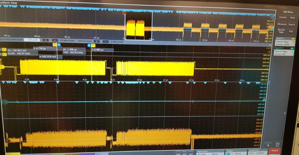

    here is the error I am seeing: when I look at the output (blue line in the photo below) of the DPHY440 part, measured at the far end (where it is currently unterminated), I get this on the oscilloscope:
    As you can imagine, this pulse could be caused by a variety of factors. So far I have ruled out termination (all terminations are removed above), power supply voltage noise (there is some noise in the rails, but that is not what is coupling in here), and simultaneous switching output possibilities (newer FPGAs are good about balancing this anyway).
    Currently, among other things, I am also considering noise coupling from the other three diff pair signals that make up the MIPI interface. If this is the case, I was wondering if I could turn off LP path on all lanes. will this be ok from the part's perspective? Anything I should look out for when running in such a configuration?

  • Hi David,

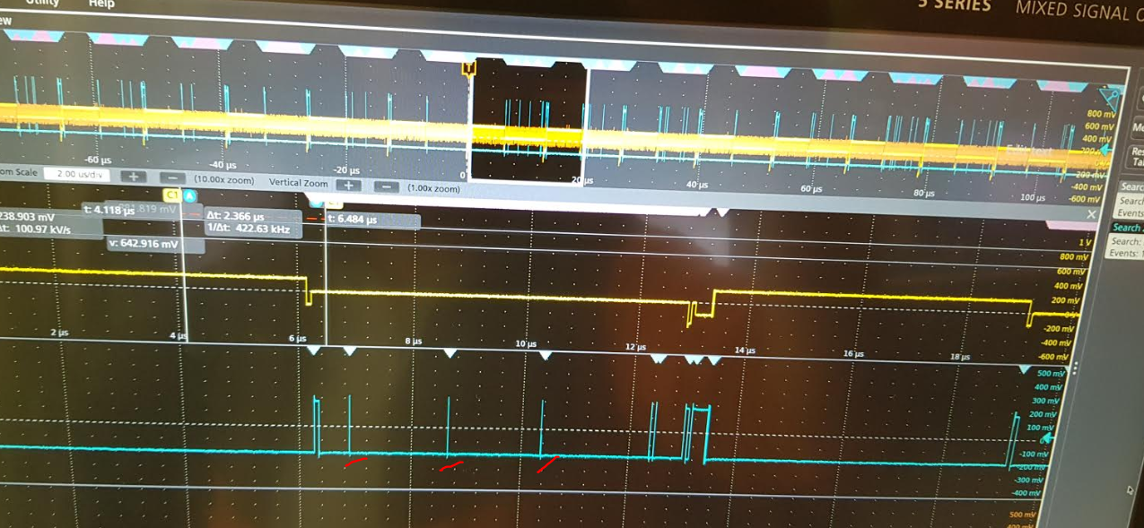

    As suggested, I tried turning LP mode off on all paths. However, it didn't work out, as shown here:
    I then decided to turn LP mode ON on all paths (basically exactly opposite of the settings above); as expected, lane 0 stopped transmitting high speed signals. However, interestingly (and for the first time), I saw the runt pulses actually line up with the event when the input signal actually toggles at LP-mode levels (fyi: new amber signal is neighboring lane 1 TX, which is apparently just chugging along fine, and not being affected by the runt pulses):
    I then wondered what would happen if I only disable LP mode on just Lane 0 (just change register 61 to 0x1E), and I get the following image where the magnitude of the runt pulse seems to decrease (which leads me to think there is some path inside the device that imposes the path on lane 0):
    To surmise, I think there is something turning on/off during the LP-mode to HS-mode transition on the input side, which is somehow bleeding through in Lane 0 of the output side.
    Is there a comprehensive document with all these registers listed, that you can share with us? I am wondering if the dynamic termination on the input side has an effect here. Since lane 0 is the only lane that can be bidirectional, there is some shared line that is feeding back this runt pulse?

  • Apologies on that:
    Channel 1-> Yellow channel is the Lane0 input to the TI part, as measured at the TI part; Channel 2 -> Blue channel is the Lane0 output of the part, as measured at the far end host's RX pins; Math Channel -> Amber channel is the lane 1 output of the TI part, as measured at the far end host's RX pins
    Is DPHY440 lane 0 connected to a un-terminated RX?: Yes it is; irrespective of terminated/unterminated, we still see these pulses

  • Hi David,
    Please note that the vertical scale was zoomed in to about 100mV/division so that only the high speed signals can be captured, and the low power transitions will be clipped. If you look at the top side of the second and third pictures closely, you will see multiple clipped yellow transition to the LP mode. Since we wanted to focus on the portion where our issue starts/ends, we are zoomed in on the HS signal.
    So, to answer your LP question, in the 1st and 3rd picture, we have just turned LP mode OFF, so we wont see the blue line match with the yellow one. And then, in the second picture, I just assumed that since LP mode is enabled, the part will not accept the settings. I would be happy to send you LP mode signaling plots if needed.

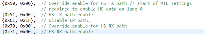

    However, since I was in there, I tried a few more settings, and realized that the following settings:
    gave me a very clean output (mostly because the output is now clipped at 1.2V instead of at the diff mode return):
    For our application, elimination of the glitch is of extreme importance. Do you see any concerns with the settings above?
    Rohan
  • Rohan
    You are enabling LP and clearing all HS enable over-ride on all the DB_P/N path. I do not see an issue with this configuration.
