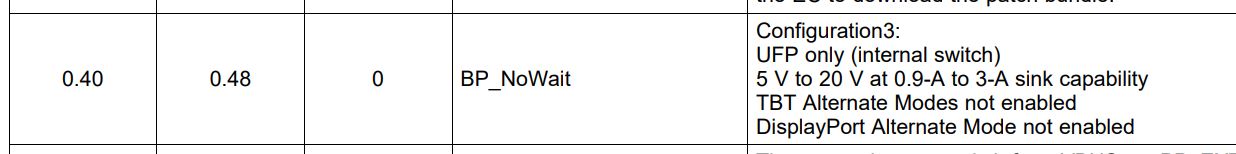

    Thanks for the response and it works. Below please find Queries for evaluating the EVM boards as an SRC alone or SNK alone?
    1. TPS65988 as SINK only: We want to evaluate that, configuring the TPS65988 always as sink and drawing the maximum power from the power bank.
    With the EVM, I have connected the VBUS PORT to the power bank through USB-C connector capable of supplying 15V/1.2A max and here we have disconnected the Power jack.
    I have changed the voltage divider resistor value for ADCIN1  to get 0.45v in order to force the Chip to configure for UFP – SINK 0-20V @ 0.9-3A (configuration 3)….Also tried bypassing the SPI flash by pressing Switch 6 while booting. But am not seeing the VBUS voltage at PP_HV pins. Tried flashing I2C patch and no luck.  Please clarify how to check with EVM board for sink configuration alone connecting it to Power bank at its VBUS port. Below is the configuration from an application note we want to evaluate

  • Hi Jones,
    1. Can you confirm that the shunts are placed on jumper J11? These are required to pass power to the rest of the EVM in dead battery mode. It is also required to hold down Switch S6 to boot into a default configuration. Otherwise, the TPS65988 will try to load from the SPI Flash. Switch S6 will need to be pressed before power is connected and released after power has been connected in order to boot into a default config.
    2. You can change the configuration on the EVM by using the TPS6598x Application Customization Tool. You can load a DFP only configuration and ensure that only 5V is present in the Source Capabilities register.
