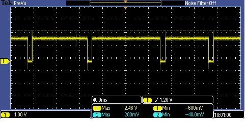

  • Hi Sir
    1. Lock signal will drop
    2. When the ESD test , the POC power supply not have any change or drop
    3. Add a DLW21SN900HQ2 not improve the ESD performance
    4. 2pF not improve
    5. link cable will check later

  • Hi Sir
    Please refer to below our test method and result for 1KV
    1. Use DACAR462 cable to test
    2. Could I config AEQ setting of DS90UB933 ? or only 936 or 954 could be modify
    3. 2pF and 10uF can't improve
    1KV ESD is very weak ,previous project use Maxim can pass at least 6kV
    Please provide your suggestion

  • Hi Mike
    We follow the suggestion to change the register ,but ESD still can't pass 1KV and change the serdes from 933 to 913
    The ESD performance is the same (can't pass 1KV)
    Do you have any idea how to improve ?
    • 934 register 0x02 bit 1 = 0
    • 0x05 and 0x06 registers set to 0xFF
  • Hi Kai,
    It looks like it is layout/shielding related.
    Can you have your TI FAE open a helpme ticket and attach the schematic, layout, and mechanical drawing?  The helpme tool is private and will protect your IP.
