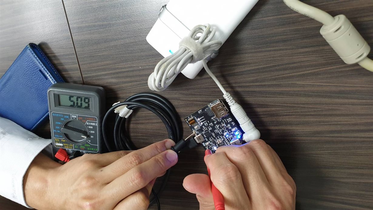

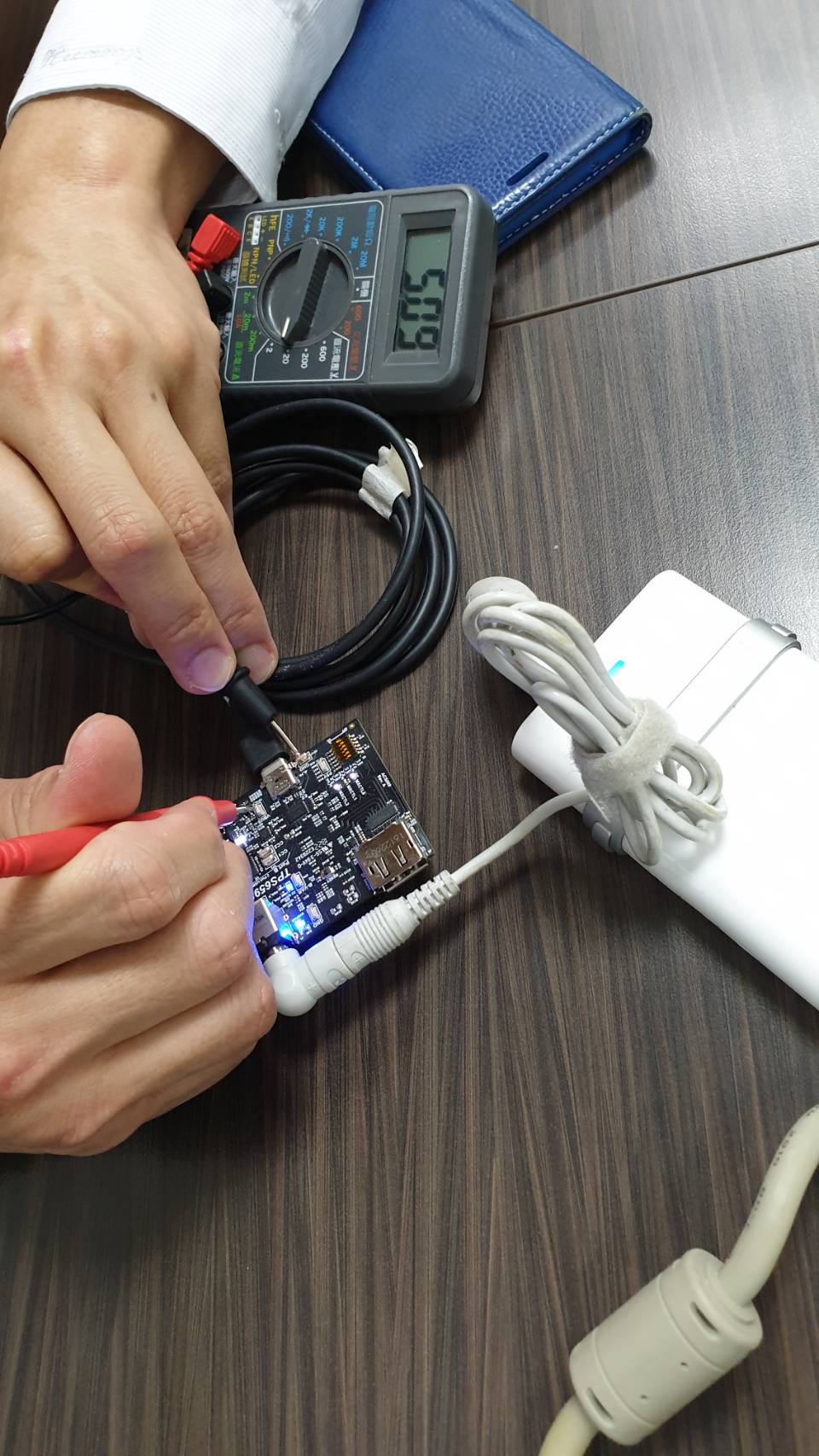

Embarrassed to ask, we can't find any example code on the web link.
We tried direct EVM verification, but we were unable to get a higher power supply.
Is there any information(workshop, training….etc) that allows us to use tps65988evm correctly.
Please help us. Thank you.
  • Hi Eric,
    Please download the TPS6598x Application Customization Tool from TI.com. This tool contains many different example templates that can be used on the TPS65988EVM. Additionally, the TPS6598x Application Customization Tool user's guide highlights how to program the EVM. These documents and links can be found on the TPS65988 product page.
