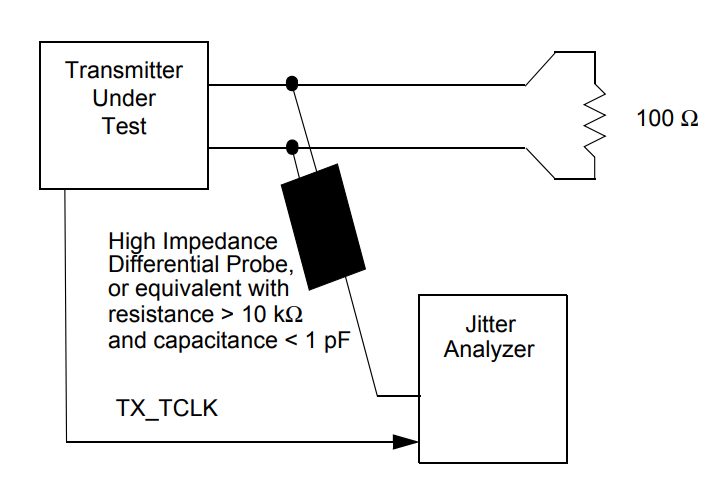

I use dp83tc811evm to do PMA test, test mode 1 is enabled by setting:
begin
// enabling test mode 1
000D 0001
000E 0836
000D 4001
000E 2000
end

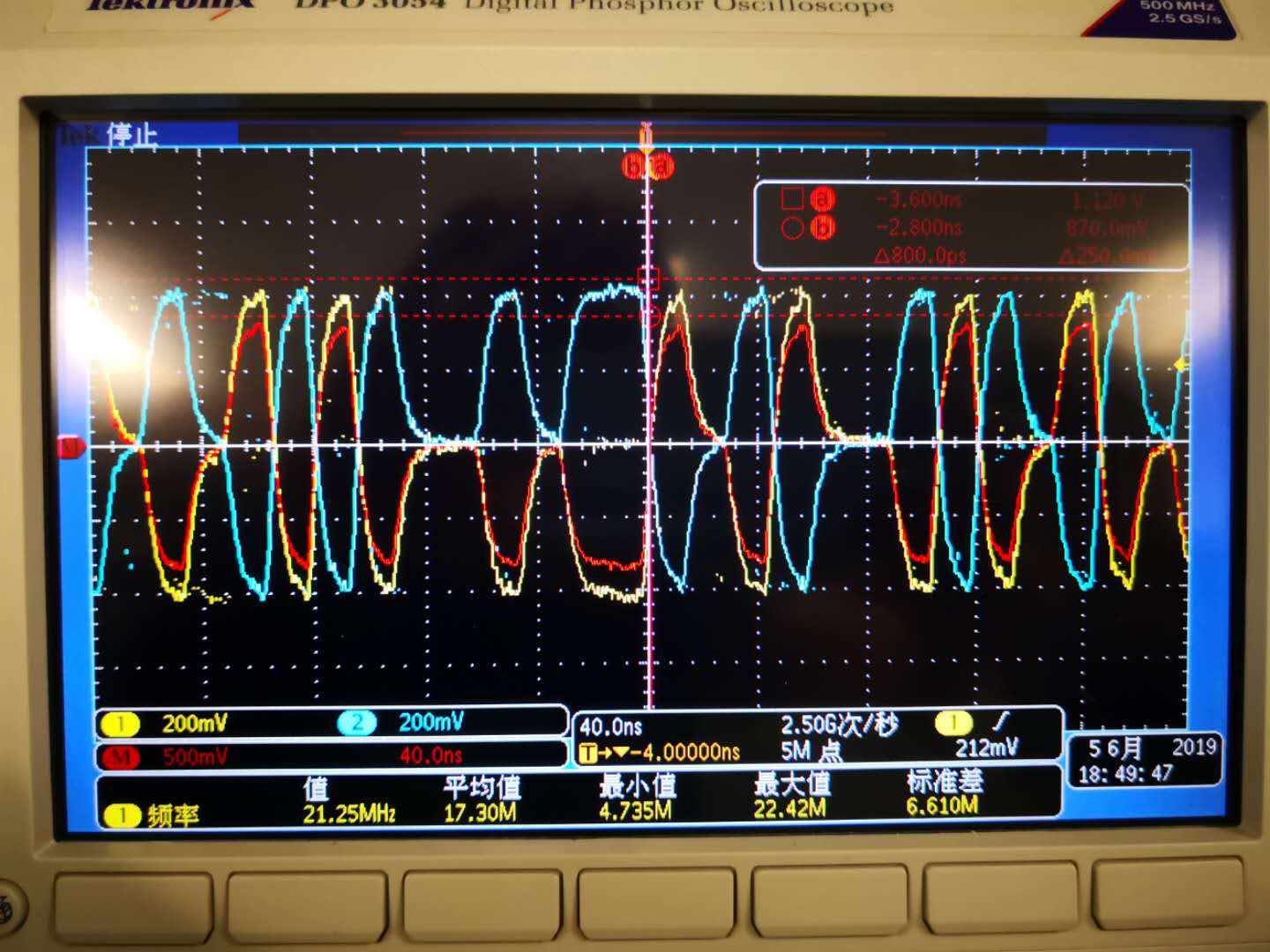

A 100ohm resistor is soldered between the connector pins (TRDP, TRD-), oscilloscope and differential probe are checked without issues. However, i don't see any difference after i enable test mode 1.
Could you let me know the possible reason and how to solve it? Thanks.
