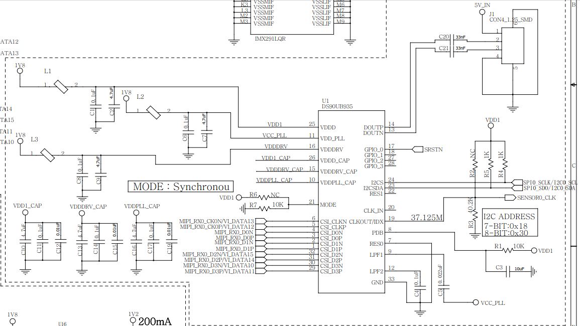

Dear Sir,
936 mode pin is in mode#4, 935 mode pin is in mode#0
In the case that the above synchronization mode cannot be locked, customer changes the 0X58 register of 936 to 0X5A (936 works in non-synchronous mode). At this time 935 does not change, 935 and 936 can be LOCK, and LOCK is stable.
But we can't read/write front end SENSOR, we use in the STP mode, how to setting the 935/936 ?
The attached file is code and sensor.IMX327LQR-C_TechnicalDatasheet_E_Rev0.2.pdf

  • Hi Vincent,
    There's a conflict in i2c alias assignment for the SER. Line 280 in your code has register 0x5C = 0x31 but Ti935_i2c_vir_addr = 0x32. Please fix this and try, if it doesn't help, please see my comments below.
    Can you have the customer measure the voltage at the MODE pin to make sure they are providing the target votlage, please share the results when done. In sync mode, the BC rate will 50Mbps. In non-sync, the BC rate is 10Mbps in Reg 0x58. Based on what you are stating, it looks like non-sync mode is working, is that right? You just can't read/write from the sensor?
    For STP mode, you just need to make sure that the hardware is set-up correctly. Make sure the AC-coupling caps are per Datasheet recommendations. In terms of software, you won't need to do anything. The FPD-Link transmission is a differential driver; therefore, it is always sending a differential signal. That is why you can either terminate the negative end on hardware and transmit as coax or not terminate it and set it up for STP.
    Mandeep Singh
  • Hi Sir,
    We had setting the 0x5C to 0x32 but don't have fix it.
    We had try to change the Mode pin voltage, Below is 936 Mode pin voltage VS status.
    Mode(V) 0x58 0x6D Lock Note
    0.995 2.5M RAW10 N Read Only
    1.1 50M CSI Mode N Read Only
    1.1 10M CSI Mode Y
    Change the 0x58 to 10M

    Below is our schematic, could you help us to check it?
    Thanks!
  • Hi Vincent,
    Yes, please refer to Table 2 in the DS90UB936-Q1 datasheet. In order to be in Sync mode, your target voltage should be 0.995V. Min/max would be 0.945V-1.0656V, so you are out of spec. Please set this voltage to make sure the part is in Sync mode during bring-up.
    I also noticed that your pull-ups are 1k on the i2c bus, have you used these before? If you see issues with i2c, I recommend having these as at least 2.2k.
    GPIO3/INTB should have a 4.7k pull-up, not a 10k.
    It is hard to read in your pictures, what is the value of the decoupling cap on the PDB pin? It should be 10uF.
    Other than this it looks okay. Please see Figure 42 & 43 for the typical connection diagram of the DS90UB936-Q1. Figure 18 for the DS90UB935-Q1. Let me know if you have any questions based on the typical connection diagram.
    Mandeep Singh
