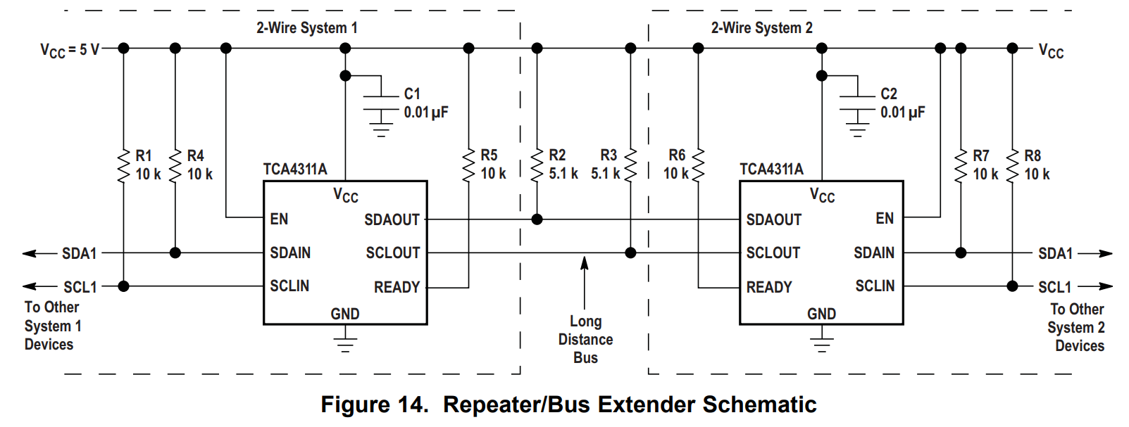

    I referenced Figure 14 in the TCA4311A datasheet, so the two TCA4311As are connected back-to-back using their "out" sides across the length of the cable. The battery can be hot-swapped at the "in" side of the TCA4311A, however, the cable can also be disconnected at the "out" side of the TCA4311A.
    I think my confusion comes from the fact that the slave is the battery, which can be hot-swapped from PCB1, and PCB1 can also be hot-swapped from PCB2. Is there a better way to approach this?

    Figure 14 actually is not referencing a hotswap application but instead, suggesting a long distance cable communication (note the long distance bus arrow in between the two devices in that figure). I personally do not like this device for that kind of application I suggest customers look at alternative devices if they need cable buffering because the Rise Time Accelerators (RTAs) in the device cause a larger di/dt resulting in inductive kick back events or harsh ringing to occur.

    3. Would it make more sense to use a buffer on either side of the cable (PCB1 and PCB2), such as the PCA9517-Q1, instead of the TCA4311A? Do you have any more information as to why rise-time accelerators should be avoided? Is it potential EMI problems?

    "Would it make more sense to use a buffer on either side of the cable (PCB1 and PCB2), such as the PCA9517-Q1, instead of the TCA4311A?"
    Depends on if the cable side has a lot of inductance or capacitance. TCA9517B would be my first suggestion if you do this but you need to make sure B sides are not connected to each other. If you have low inductance/capacitance then you don't need an I2C buffer.
    Do you have any more information as to why rise-time accelerators should be avoided? Is it potential EMI problems?"
    If the line is inductive, you will see ringing occur during the rising/falling edges. You may see reflections in the signal which could result in the rise time accelerators accidentally triggering itself (I've seen cases where they just oscillate). Mainly due to parasitics and the fast di/dt of the rising edges. Not exactly EMI problems.
