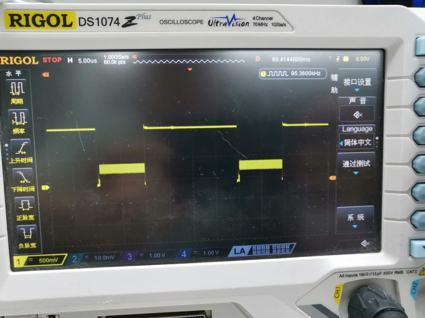

         I've finished to make my ASIC driving a LCD display the color bar which was generated by DS90UB954,the mistake is caused by the mipi phy clock,i change it to 800MHZ and change the line period to  B93 (29.63us) and than i find the wave show that fps =30fps and  line period is 29.63us (29.63us*1125 =33.3375ms)

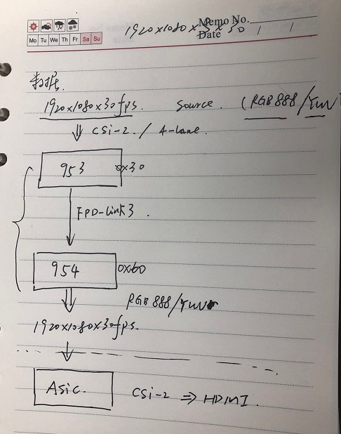

            My source is 1920x1080 30fps Yuv422 in mipi package with 4-lane,400Mbps phy

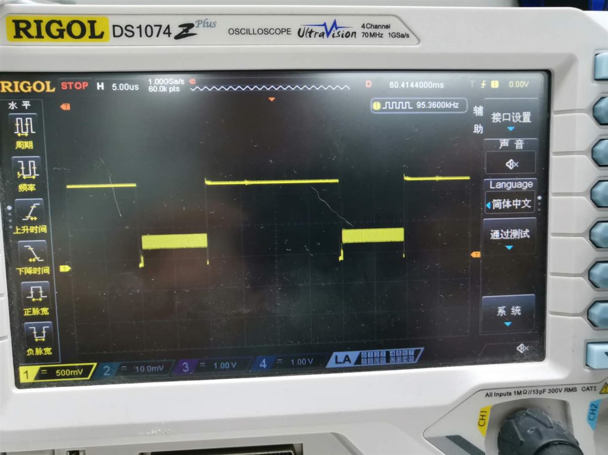

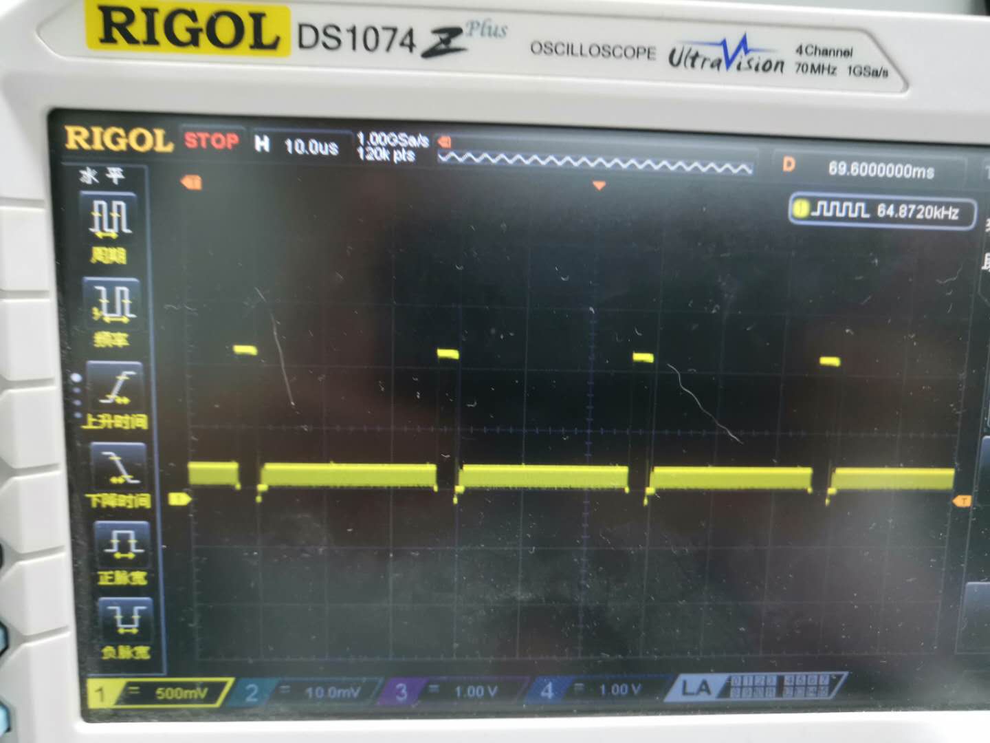

            I find signal input to 953 is different from output from 954  like fellow
            input 953:
    output on 954
    ①you can see every line period  is 29.63us ,953 input is about 355Mbps per one lane ,but at 954 csi output port,just less than half of one period is used for transmit a mipi line,what caused that?

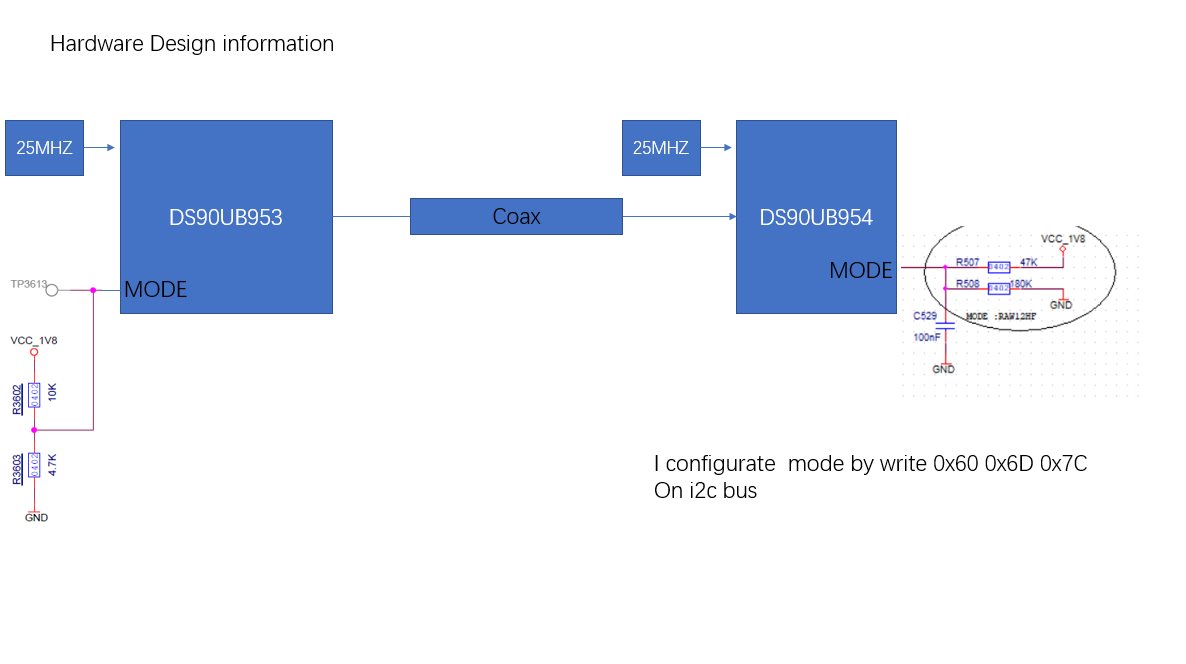

  • Dear Casey:
    thanks for your replay.

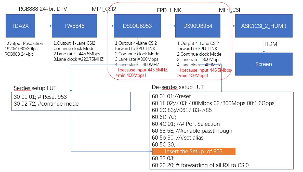

    i know that 953&953 have no ability to do the color spaces transformation,my design detail is shown like fellow,we do this CSC on ASIC TW8846,but i know if CSI-2 data stream with YUV cost a lower Bandwidth,and just need 400Mbps MIPI Phy but if rgb888 ,there needs the 800Mbps Phy of 954&953,however,hypothesis input source is RGB888
    Does my setup is ok? i need a help to check of them。
    And i do not know how to set the mode pin, i see many of the application is 953 input with an RAW8,10,12bit sensor data,but my application is using 953,954 for display link.
    Your setup looks ok except the CLKIN applied to the 953 should be 50MHz, not 25MHz for 4Gbps operation. For synchronous mode you don't need to have any local CLKIN applied to the 953 since it can use the back channel from the 954 as a reference but if you use non-syncronous mode where you apply a CLKIN directly to 953 then you need 50MHz for 4G and 25MHz can be used for 2G operation as per table 6 in the datasheet. (FC rate = CLKIN*80).
    Since you are using 445Mbps/lane, you will need ~1780Mbps of CSI bandwidth. The CSI bandwidth is calculated as f*64 for non-synchronous mode so if you use 25MHz at 953, then CSI bandwidth = 25*64 = 1600Mbps which is not enough. Please either use synchronous mode or switch the 953 CLKIN to 50MHz. Also remember for non-synchronous mode the back channel rate must be reduced from the 954 side as well so I would suggest simply using synchronous mode.
    Table 8 in the 953 datasheet explains the strapping for synchronous mode.
    Casey

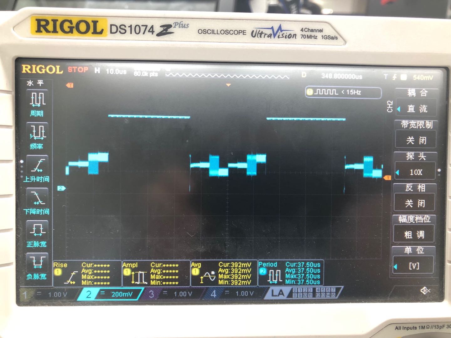

  • HELLO Casey:
              I've test the output signal wave,It's right ,but i've not  finish the display working.
  • Thanks  and i've solved this problem   ^_^
