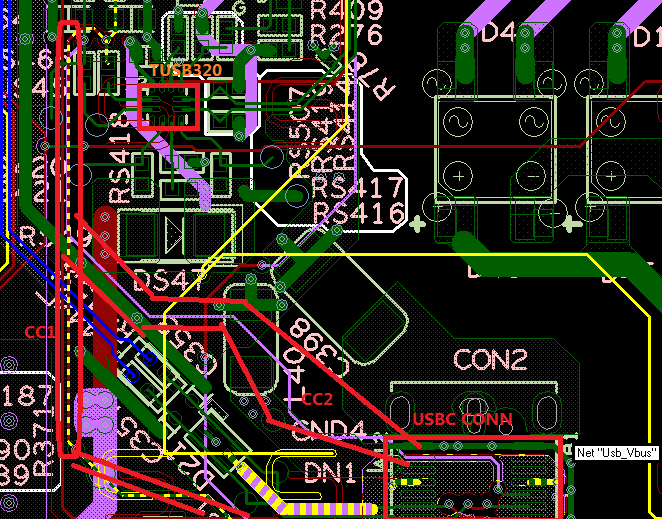

Our schematic as below.
Our USB C is connected to the computer through the cable. The Type C connector is inserted in a certain direction. The level of cc1/cc2 is about 0.45V, and the other side is inserted, cc1/cc2 level. It is 0, but the USB_ID of both states is high.
Looks it's not be automatic detecttion .
Could you help to check i?, thanks!!.

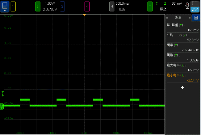

    But measured, the two CCs are in the state of continuous switching between high and low levels, the ID has no change - always high level
    3. Using USB C connect to the computer directly via USB 2.0 cable
      a) The board is powered by POE. The measured two CCs are at 0.4V/0V low level, and the ID has no change - always high level.
      b) The board is directly connected to the PC and powered by the computer. The measured two CCs are at 0.4V/0V low level, and the ID has no change - always high level.

    It is important to remember that type c cables only carry one CC line across the cable, so one CC line at 0 V this should be expected in the normal case. This device is bus powered in this application? Is the accessory mode enabled? Could you capture the wave form for a longer period of time?

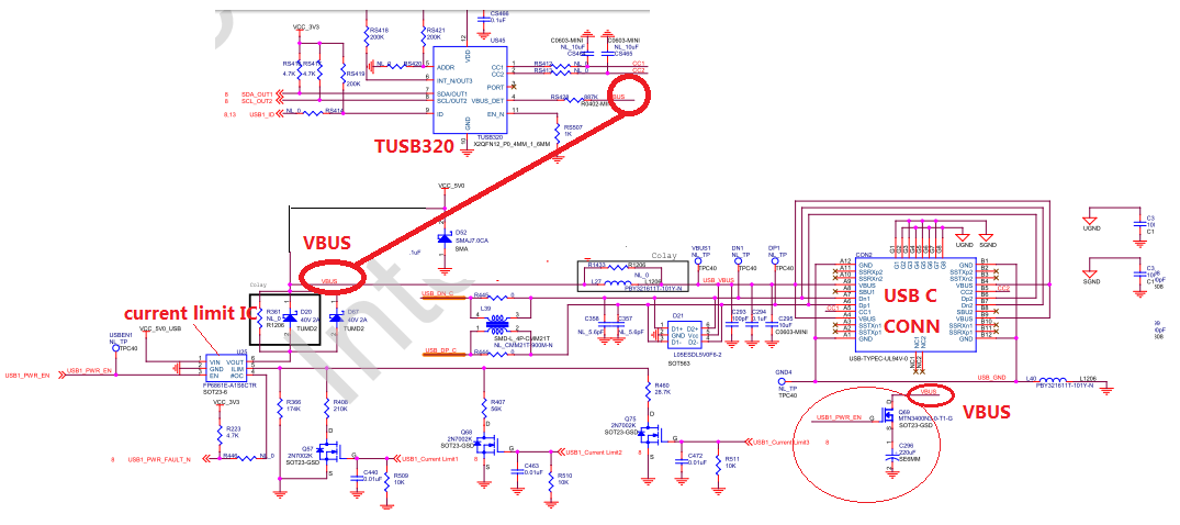

    Please refer to the attached schematic about the USB C port application, we used the USB C as a DRP mode as well as DC power input port.

    On the CC line toggling, CC 1 and CC 2 will toggle when TUSB320 is configured to support accessory devices in UFP mode or in DRP (waiting for connection) ID should be asserted low when CC pin detected device attachment when port is a source (DFP), or dual-role (DRP) acting as source (DFP). In UFP mode TUSB320 will hold ID in tri-state, which is why ID may be held high always in this case. Could you verify that TUSB320 is not in UFP mode or DRP presenting as UFP? Also to confirm, you are using TUSB320 and not TUSB320LAI/HAI, correct?

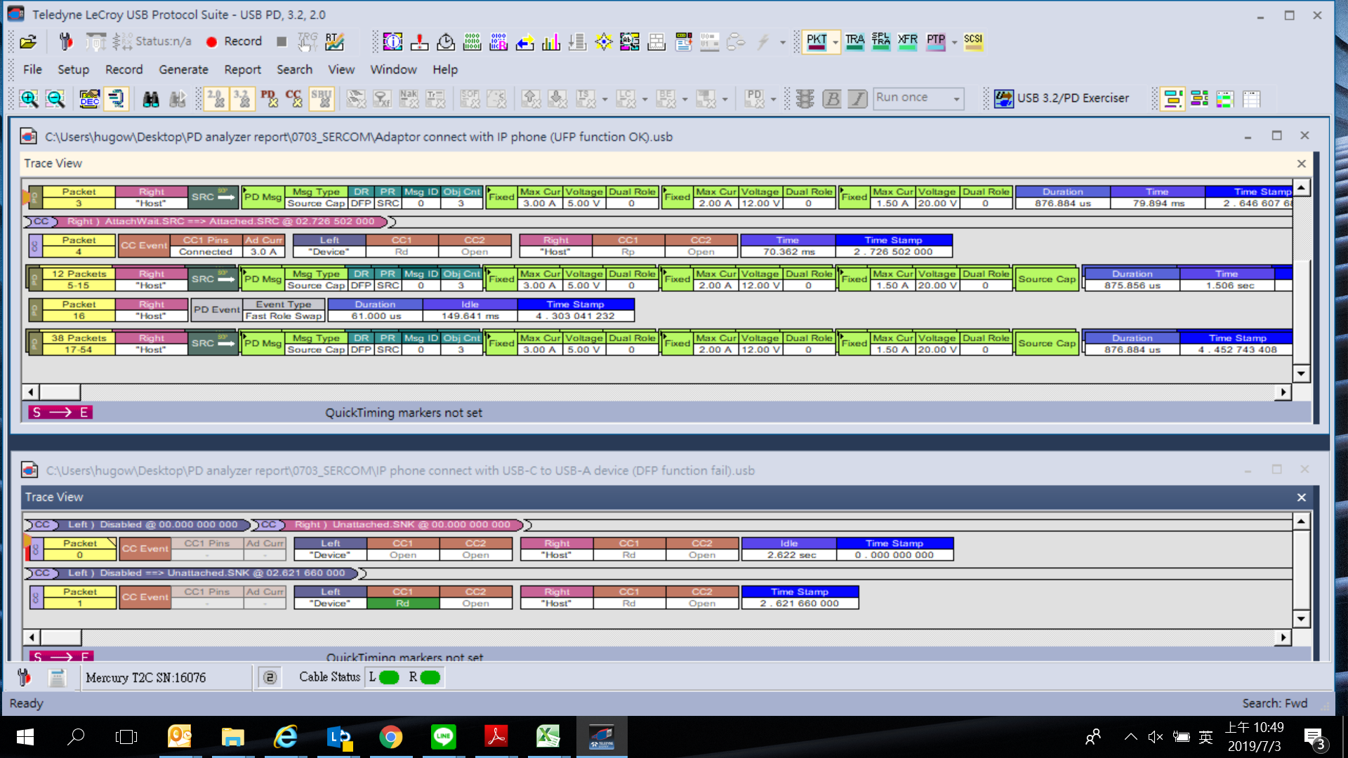

    We have to log USB protocol as below.
    Looks our device always be fixed on UFP mode.
    But we are setting TUSB320 to DRP mode.
    So could you help check what wrong for our design?
    By the way, our application is IP phone.
    Schematic:
    Schematic-已編輯.pdf
    1. Adapter connect to IP Phone ( UFP function OK)
    2. IP phone connect to (USB-C to USB-A device) (DFP function fail).

  • do you have vbus switch ? for  DFP, Vbus should not be connected before a UFP is connected.
  • Hi Sirs,
    Thanks for your reply
    It is verified that after changing the VBUS power supply timing, DFP Mode detection can be implemented.

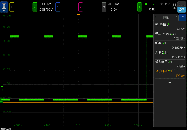

  • what the voltage on CC pin in DFP mode?
  • Hi Brian,
    Thanks for your reply.
    CC1 had 570mV, CC2 still keep low voltage level.
  • Hi Sirs,
    Sorry for pushed, have any update on here?

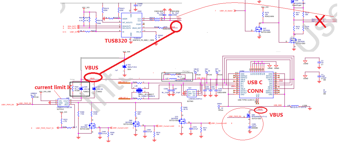

  • probably still no in DFP mode, after plug in, you will see one cc pin high/one cc pin low. once MCU see ID goes low than turn on the Vbus. so Vbus should be on after ID pin goes low.

  • Hi Sirs,
    Thanks for your reply, after add power switch to control power sequence looks the function could be work on DFP.
    I'll to close this topic.
