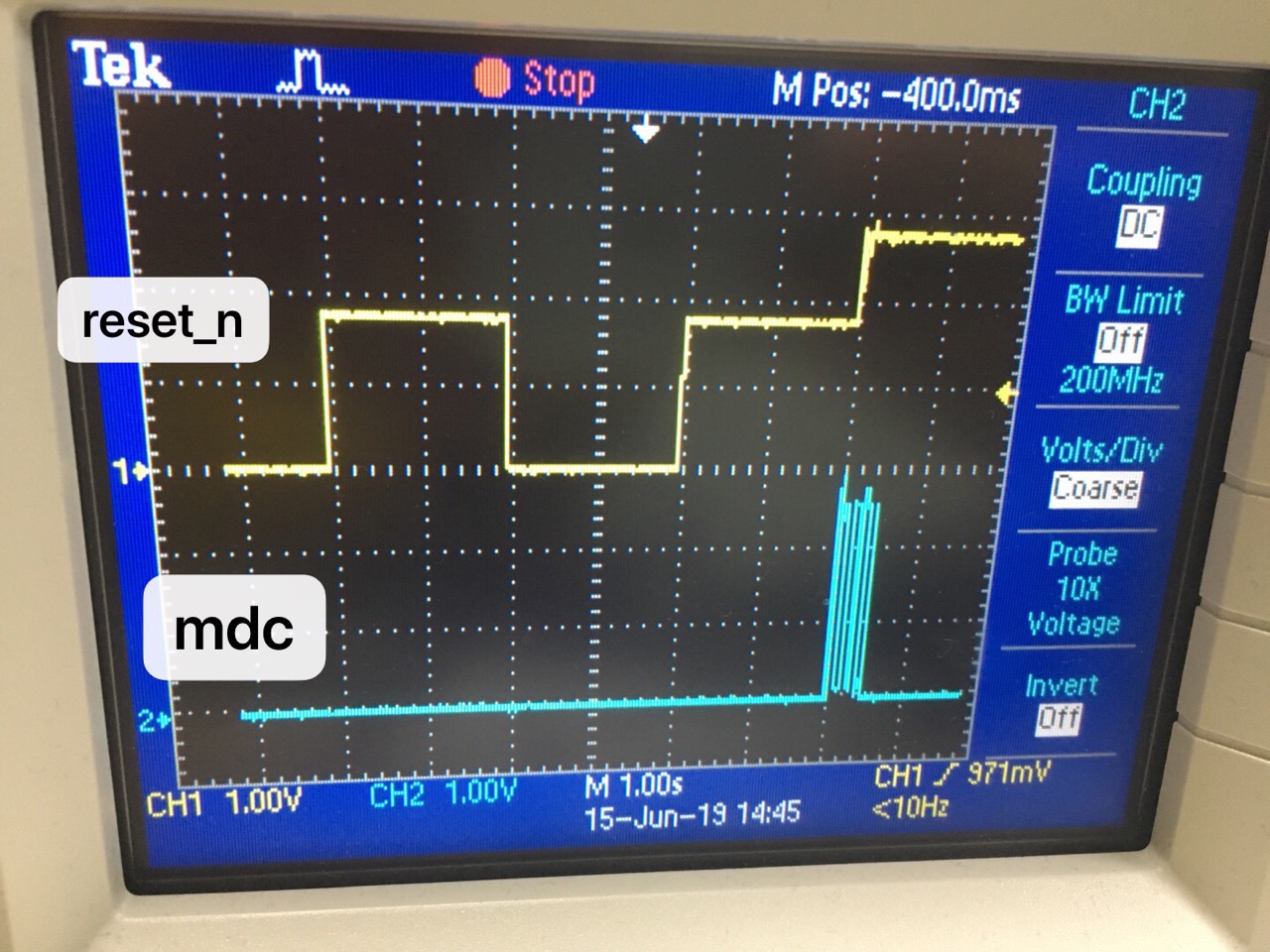

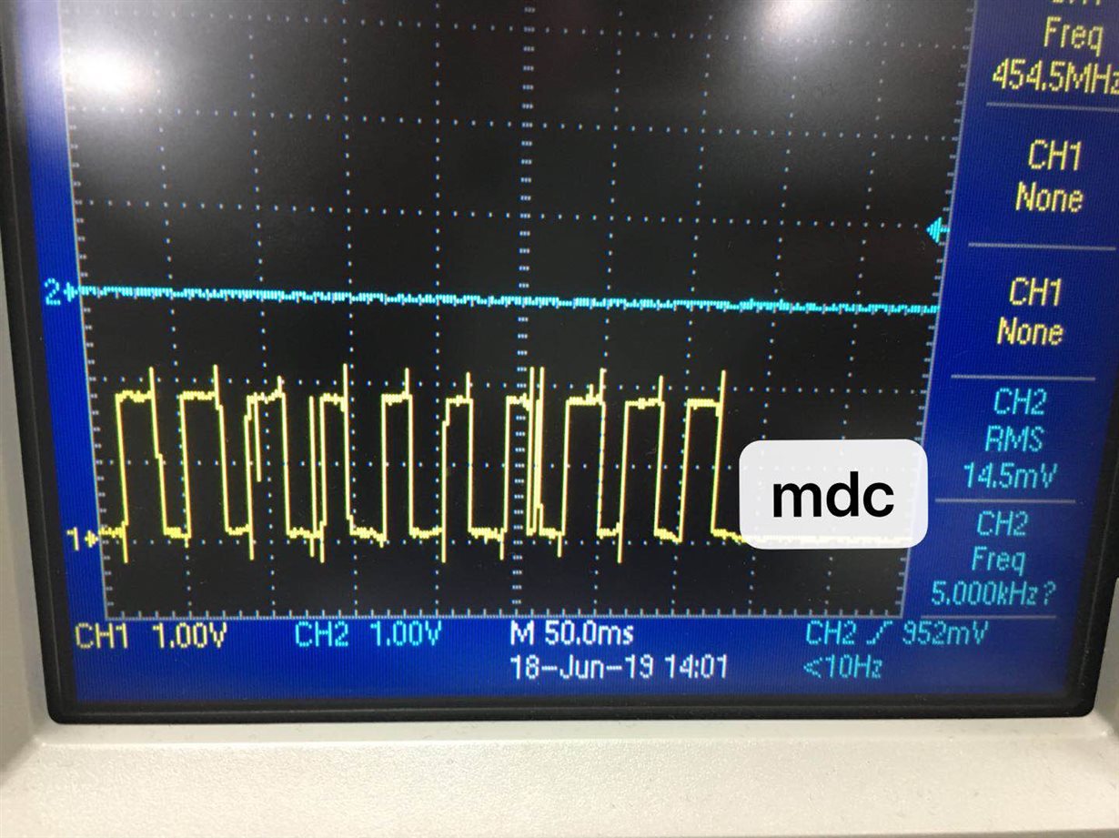

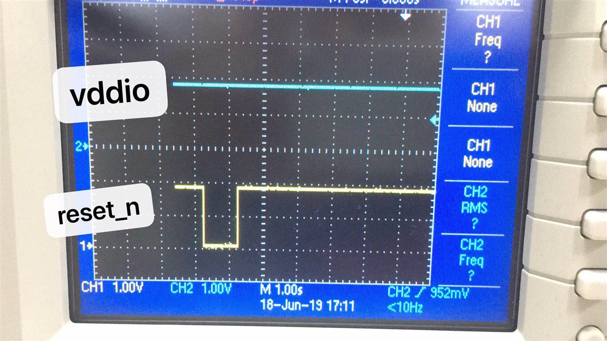

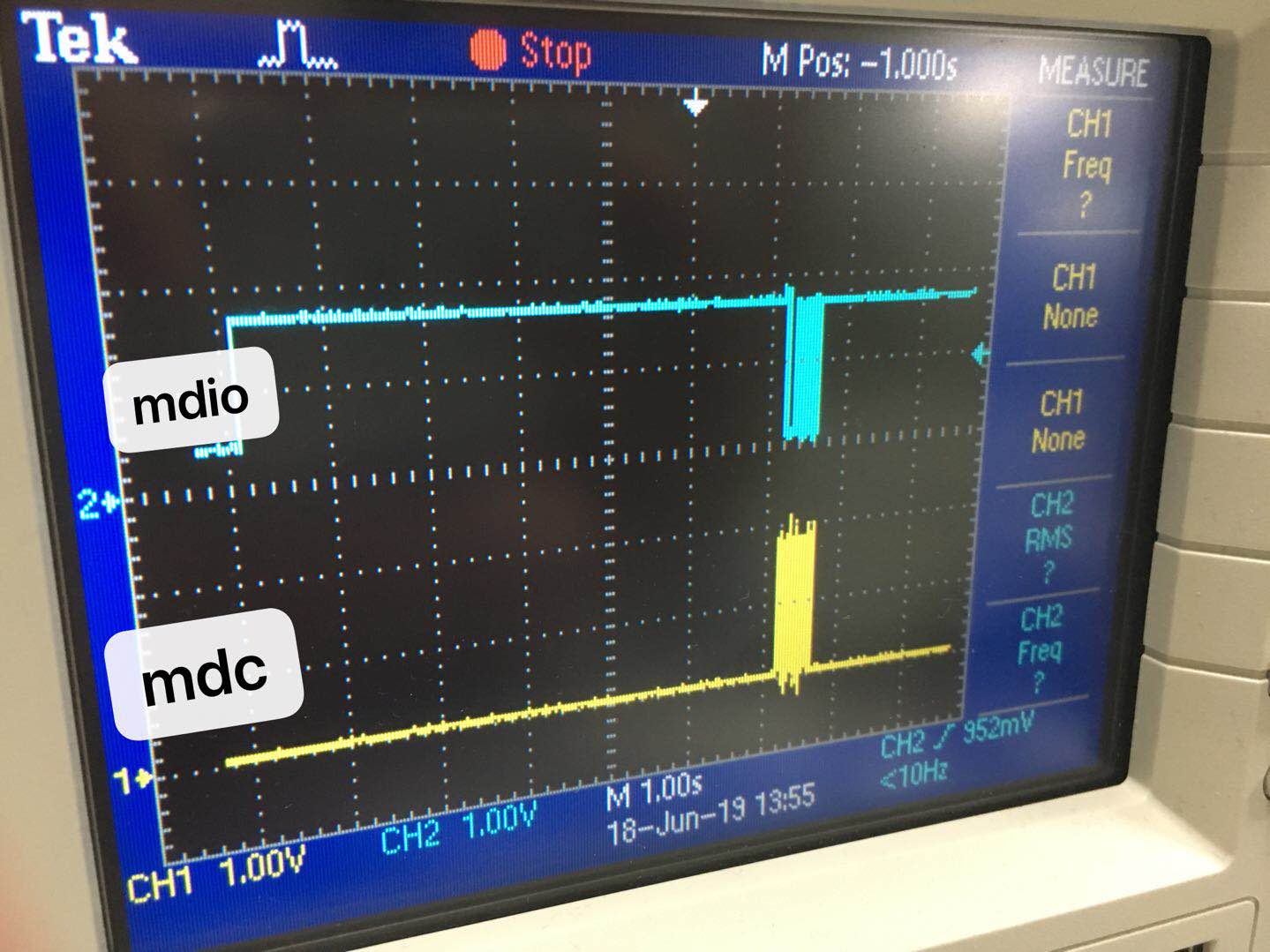

  • Hi
    Thanks for your replied.
        Now we use DP83TC811S phy chip, but we don't know about adress, the reference specification is related to 14 and 15 pin, we use sgmii, no 14 and 15 Pin were connected, we now configured phy address is 0, the read id is as follows
    423 [    0.569883] get_phy_id()
     424 [    0.569901] get_phy_id() trying to read MII_BMCR=0xffff
     425 [    0.569924] get_phy_id() trying to read MII_BMSR=0xffff
     426 [    0.569947] get_phy_id() phy_id = 0xffffffff
    • Could you Please help to confirm what is the address?

    - You can scan the PHY address from 0 to 15 to see if there is any response.
    - If not, check and make sure the reference clock on XI pin is toggling at 25MHz.
    - How do you control the RESET_N pin? Make sure this pin is High after power up.
    - You are using 1.8V VDDIO. So make sure the host (the device issuing the MDC/MDIO command) is running off 1.8V.

  •  Nguyen,
    We verify that the reset_n output is high to low to high, and then power up
    Print in the code, print out the ids of 32 devices on the bus, and it is found that all are oxffffffff (there is no device found). We measure the 25M of XI is normal, and the waveform captured in the pictures nearby
  • Hi Jimmy,
    1. Why does RESET_N go up and down?
    2. Your design uses 1.8V VDDIO. However, RESET_N goes to 1.8V and then shoot up to close to 3.3V. As mentioned earlier, please make sure the host also uses 1.8V VDDIO. The MDC also has ~2.5V swing. If there is mismatch in voltage level between DP83TC811 and the host, you will need to add a voltage translator device between the two devices.

  • Hi Hung,
    1. Why does RESET_N go up and down?-- We refer datasheet Figure 10
    2,Equipment vddio is 1.8 v, the voltage device up, we have put the reset_n high level operation, the system ran the probe, the MDC and mdio will have instant data, behind.  probably the equipment couldn't find it, so just moments have a signal,.we read id is 0XFFFFFFFF, now the below picture is our test signals, including vddio reset_n, MDC and mdio
  • Hi Jimmy,
    - Your schematic shows 22K Ohm pull-up on MDIO. Can you change it to 2.2K to see if it helps?
    - MDC/MDIO command is from Atheros device. Please make sure that device is working.
    - As the PHY registers are 16-bit wide, how do they map into 32-bit field that you read from Atheros device?
    - What is the frequency of MDC? Make sure the MDC is toggling for 33 cycles or more.
