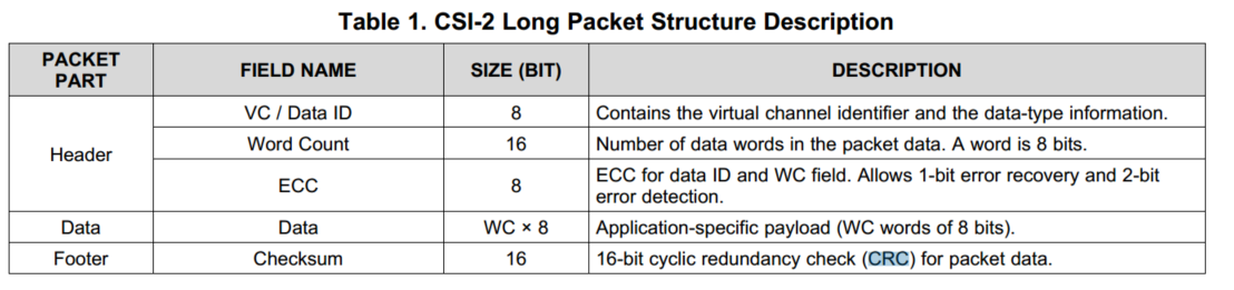

We are trying to understand if CSI-2 frame that receives by Serializer(953) passing-through transparently to CSI-2 interface at Deserializer?
Original CRC that lays within the CSI-2 footer from the Image sensor is removed by Serializer, checked and regenerated on Deserializer side when wrapped a new CSI-2 frame?

  • Hi Casey, thank you for reply.
    I understand that the csi-2 data is passthrough, but what about the original 16crc header? Is it removed on 953 and generated again on 954 side?
  • Hello Alon,
    No it should just be passed through as well.

    I will explain our approach for the image path integrity : please correct me if I am wrong.
    The Image sensor transmits a CSI-2 frame which contains a Header(ID,WC, ECC), Data (pixels), and Footer (16 CRC).
    1. The Serializer (953) extract the data, computes the CRC and ECC to check for corruption MIPI link. Assuming a default configuration. in case the serializer finds ECC or CRC error, CSI_ERR_STATUS (Address 0x5D)  will be flagged. (953 datasheet, Table 94), ALARM_CSI_EN (Address 0x1C)  default is to set an alarm to the corresponding ECC\CRC error, what is this alarm?

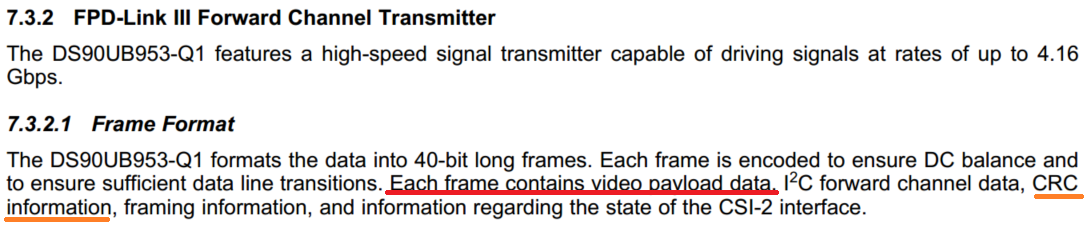

    3. by 953 datasheet :
    3.1 "Each frame contains video payload data"  That means that the FPD link contains the Video payload data only from the CSI2 frame?? this is why I asked about the original Header and Footer from the CSI-2...
    3.2 "CRC information" Is that the Forward channel CRC for the FPD from? what type of CRC?
    Thanks again,
  • Alon,
    1. For example, if the 953 CSI-2 RX encounters an SOT error, this may cause the whole lock/short packet to not get recognized rather than just causing a single data bit error. That is why I think the behavior could be unpredictable
    2. For the 953, you will get checksum for the CSI-2 packets being received, but if there are some single bit errors in the FPD Link forward channel it is possible that errors can be introduced there as well, and then the DES may be able to detect a CSI-2 error on the receive side. Also remember that checksum is only done for the packet header, not the data bits as the SERDES have no knowledge of the expected data
    3. The FPD frame includes the CSI-2 header/footer information too. We call this all "video payload". CRC is for the back channel in order to detect errors in the low speed control channel.
