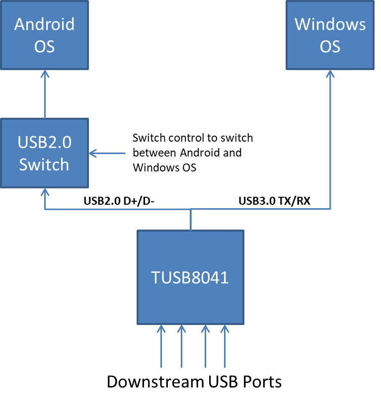

Our customer has a use case for TUSB8041 is to switch between Android OS and Windows OS sometime, block diagram showing as below. Now they found one issue is:
1. Switching in Android OS USB2.0, connected U-disk to downstream USB ports can be detected.
2. Then switching to Windows OS using USB3.0.
3. Then switching to Android OS USB2.0 again, inset the U-disk to downstream USB ports, but it can not be detected, unless you reset TUSB8041 by GRSTZ pin.
Do you know what's the problem in here?
