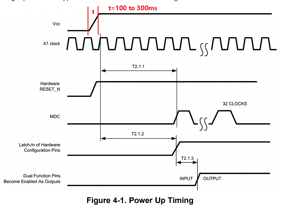

For the power up timing, if the rise time for the Vcc is 100 to 300ms, is there any potential risk that the DP83848Q will not work?

Hi Hao,
No specific ramp rates are defined. There should not be any risk that the device will not work.
