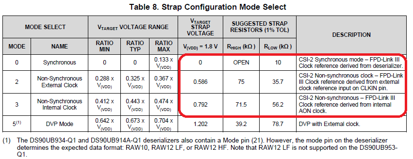

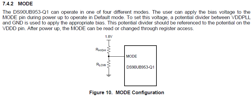

We are studying of the 953 Mode setting clock have questions.

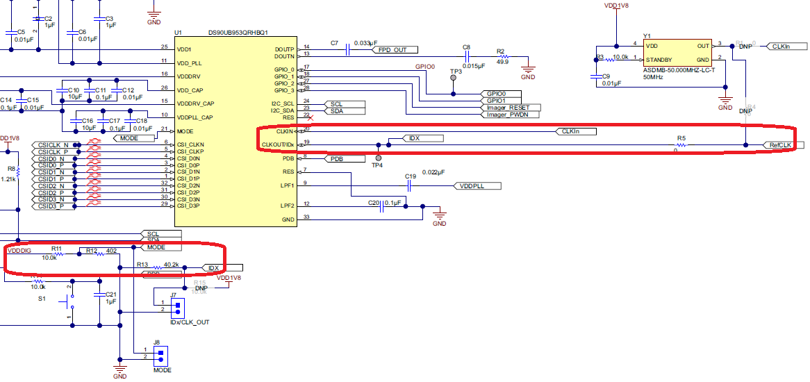

Below is the suggested schematic from the UB953-EVM, as shown by the red circle below.

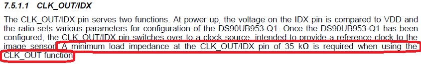

1. If you use external clock (oscillator), the EVM schematic is not connected to 35K Ohm, but there is a write in the datasheet, please see 7.5.1.1. CLK_OUT/IDX
2. EVM's R11 (10K) and R12 (402) Voltage in the datasheet are not ot meeting data, why deliberately use 402R? This mode setting is provided by 954 clock to 953.

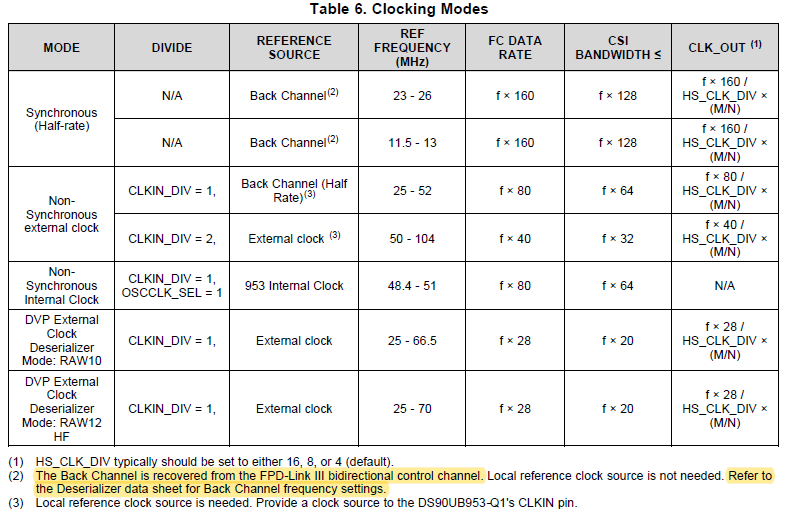

We are currently setting the same 50MHz using external clock (oscillator)
