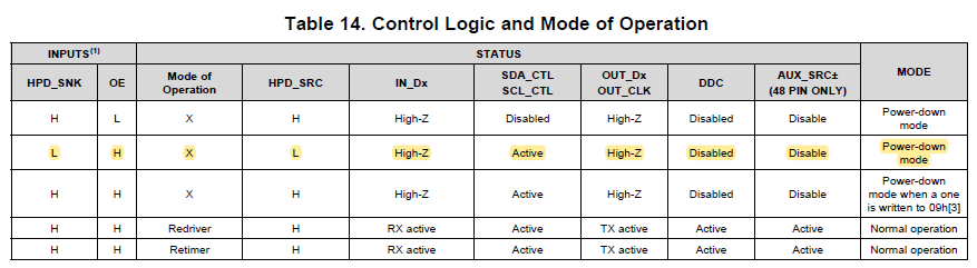

Can the SN65DP159 register be set in power down mode?
We want to change "HPD_AUTO_PWRDWN_DISABLE (09h bit 2)" to 1 when SN65DP159 is in power down mode.
The OE pin is high and HPD_SNK is low.
The data sheet states that I2C is active.
  • since OE pin is high, I2C is still active, but DDC is disabled it's not working as normal mode

    We understand that if the OE pin is high, then we can write to the register.
    ・ I thought that "HPD_AUTO_PWRDWN_DISABLE (09h bit 2)" is a register that prevents HPD_SNK from entering power-down mode even if it is LOW. However, according to your explanation, if HPD_SNK is LOW even if 09h bit 2 is set, it will enter power-down mode. How is this register used?
    ・ We think that the register will not be cleared even if it becomes High after writing to the register with HPD_SNK LOW, is it correct? (Except TMDS_CLOCK_RATIO_STATUS bit)
  • It is not cleared by HPD_SNK low.  It is cleared by software or power-on reset.

    We understood that even if HPD is LOW, the register settings are not cleared.
    We thought that in the power down mode the register settings would be cleared.
    The question has been resolved.
