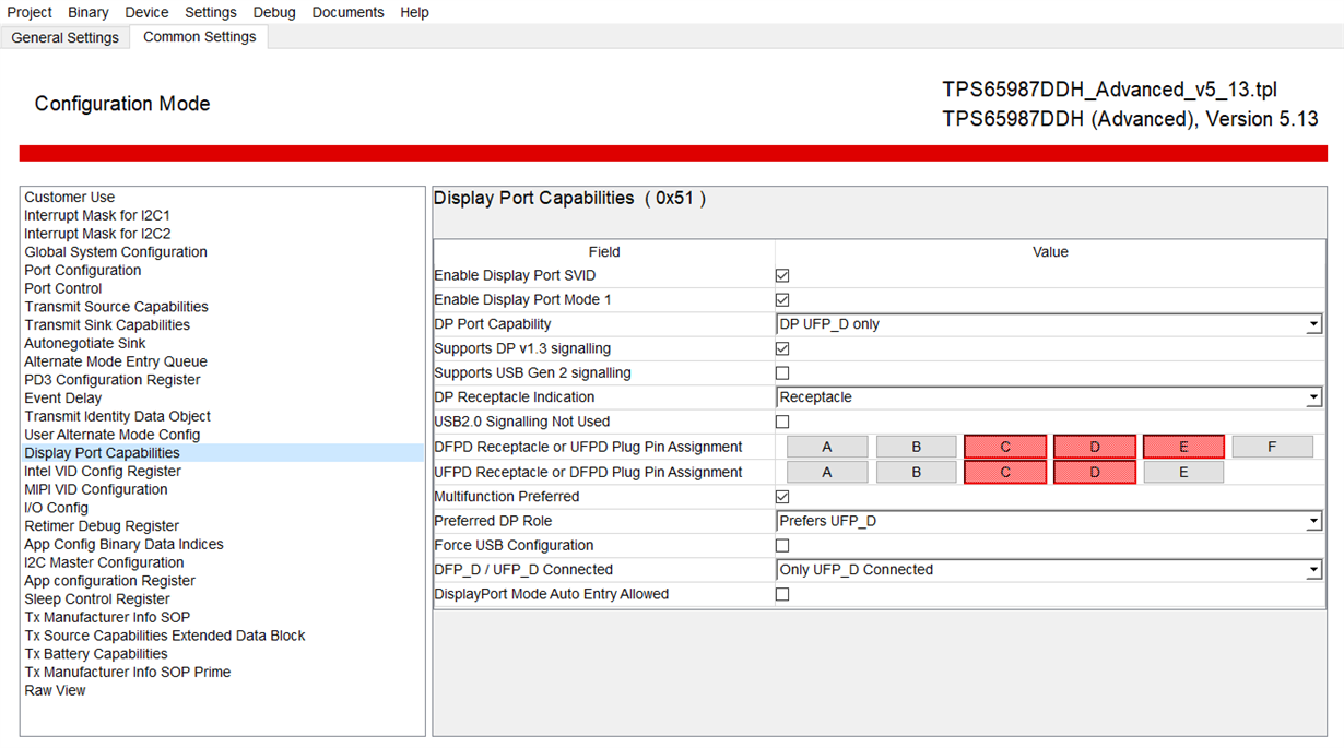

Hello everyone again.
I am working on video sink and power solution for USB Type-C using TPS65987D.
I did get everything working with Chromebook from CTI.
However, for some reason only power works with Samsung S9 or S10 smartphones.
I did search this forum and found one of treads that talks about no video from S8; however,
in Samsung documentation it says that these smartphones support DisplayPort over USB-C.
Is there anything special needs to be set Samsung to start outputting video on USB-C, and if it is, what is it?
