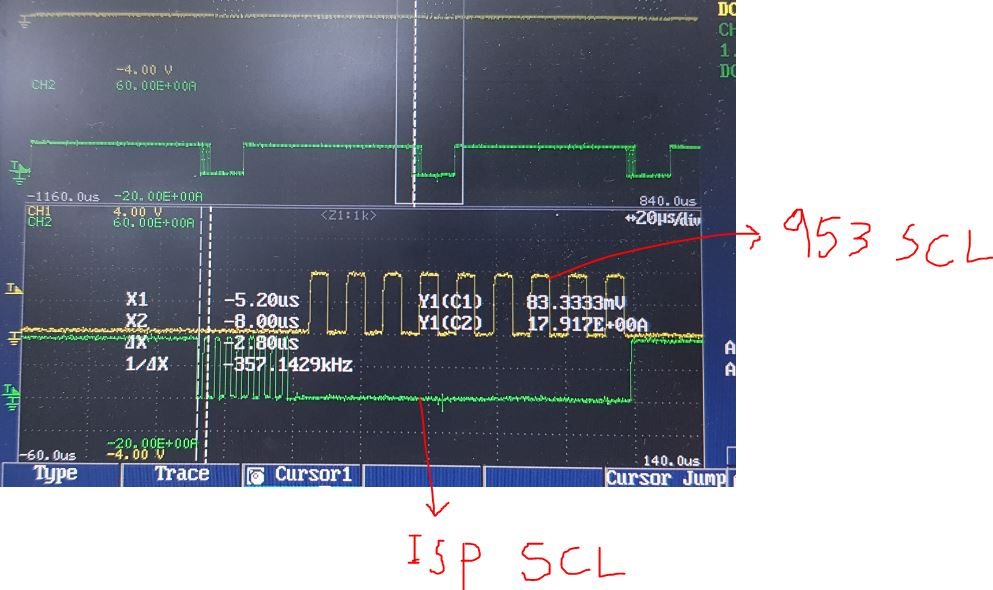

  • Thank you for your reply.
    We succeeded in calling 953 with I2C, but we can not do full i2C communication like the following waveform.
    I think it is caused by CLOCK STRETCH.
    I am communicating with OMNIVISION OV580, but OV580 does not seem to support CLOCK STRETCH.
    Is there a circuit configuration and IC that can do the CLOCK STRETCH implementation externally, or is there any way to get a little effect on the clock stretching from 954-953?
    Please check it.
    Thank you
    Best Regards
    From anthony.
  • Hi Anthony,
    The imager shouldn't have to support clock stretching since it's a slave. The only hardware that needs to support clock stretching is the process on the deserializer side. Clock stretching is supported on the software side. Please check your processor and see if you can enable clock stretching there.

  • Hi Anthony,
    Unfortunately, I don't believe there's any way to configure for clock stretching without using a different ISP.
    Jiashow
