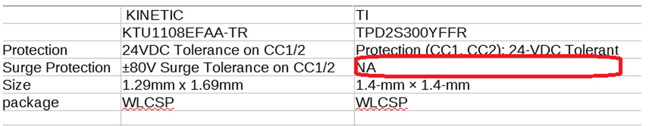

Hi Team,
We meet a competitor which has surge protection.
Seems TPD2S300 don't have surge protection, right?
Hello Daniel,
That is correct, the TPD2S300 does not offer surge protection. If that is a feature you would like, you would have to accompany it with one of our TVS solutions like the TVS2200
