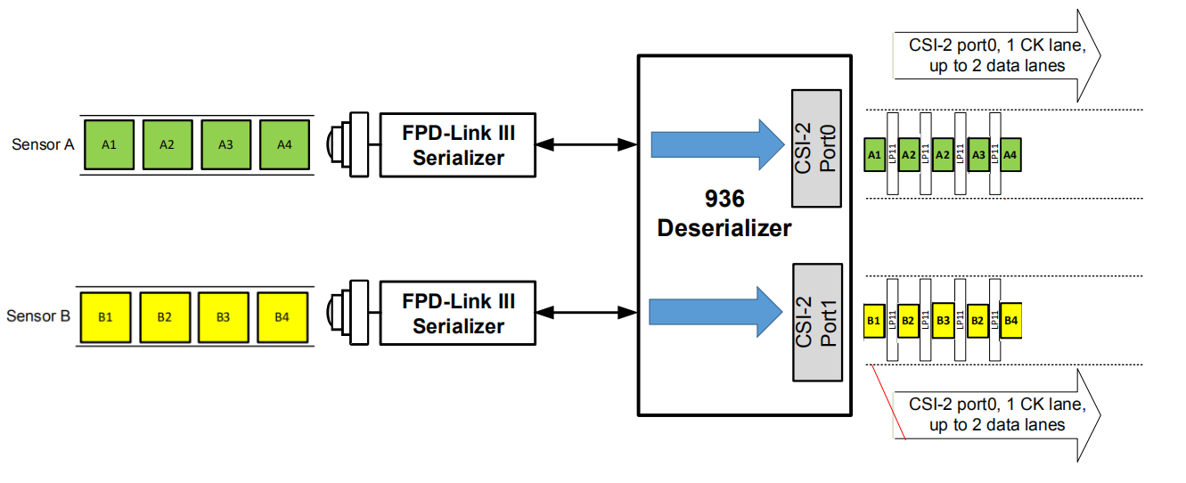

As shown below, sensor A data is output from the 936 CSI-2 Port 0, and sensor B data is output from the 936 CSI-2 Port 1. Is this achievable? How to configure?

Sorry, this can't work. pls check 936 d/s, it can't support this mode.
but port1 can duplicate the port0 output, that is to say, both port0 and port1 output both sensorA and sensorB video data, this is described in 936 d/s as well. of course, if you select this mode, you should make sure the 2lanes' CSI2 bandwidth can catch your sensorA and sensroB's video bandwidth.
