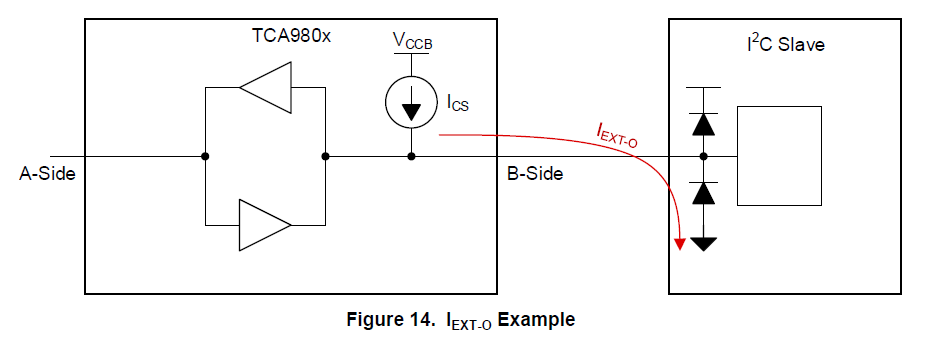

Hi team,
My customer is using the TCA9617A now, they think the VOL 0.5v is too high for them, and want to change to TCA9800, but we want to check whether it can connect with DDR SPD, it seems to be cannot for the B side internal current source. Thanks.
