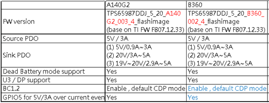

    Below is our projects configuration.
  • Hi Milan,
