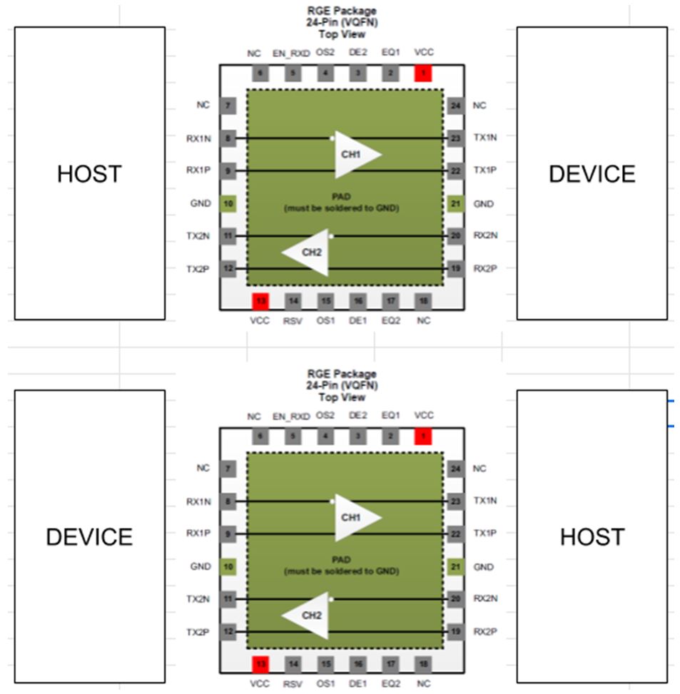

    I'll need some time to obtain the eye diagram as customer is rushing on P2 build for their project. For schematic connection, it resembles the EVM schematic hence result should be pretty much the same. Also can you verify if TUSB522P is reversible? Meaning that it doesn't matter which side faces the device / host. Can you verify if my understanding on the following diagram was correct?
    The eye diagram results will vary based on the layout of the PCB even if the schematics are very similar or the same. TUSB522P is reversible as long as the routing is correct.
