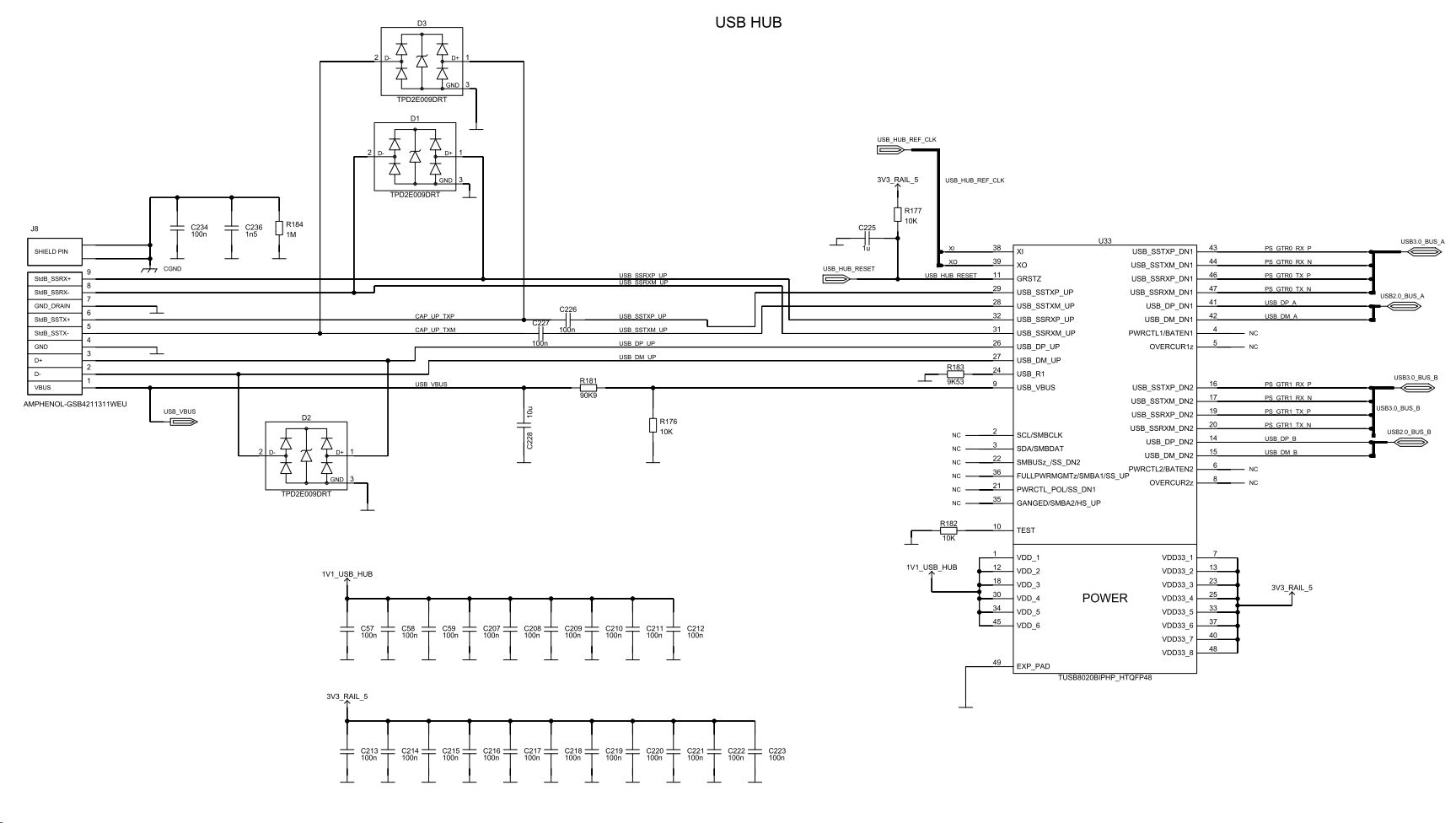

I have a design with tusb8020b on my pcb.  All downstream ports are connected to a CPU on the board (USB 2.0 via 2 external phy’s (usb3315)).
Both hub and phy´s are powered from the board. When cable is attached from computer to usb connector to hub, the hub shows up but no visible devices can be seen (enumeration doesn’t occur).
The configuration of the device is the default (no programming via smbus, eeprom etc).
Crystal is used as clock source.
I need help to solve why the hub doesn’t connect to the underlying devices.
Below is snip of the schematic;
Br Mikael
