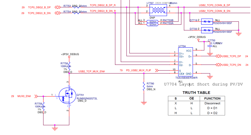

Hi Sirs,
Sorry to bother you.
For DEMUX SW TS3USB30ERSWR if it no connect the VCC power, what is the switch D+/D- behavior ? It still can work ?
Our application as indicated below, DEMUX SW connect to USB2.0 signal, but +3P3_DEBUG no connect the power. Is the USB2.0 signal still can work? OE pin always pull low, S pin as control pin.
