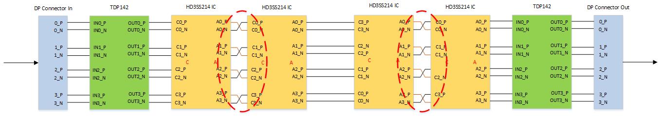

HD3SS214: HighSpeed Signal Lane Configuration
Part Number: HD3SS214
I am making a 4x4 DP 1.4 SW using HD3SS214 Switch IC. I want to configure my high speed signal lane as the image below (This configuration is the same as port B of HD3SS214 Switch IC). Unfortunately, I  can't find any document that talks about this configuration, so I confuse that will this configuration work well? If you know about this, could you please answer my question? I am looking forward to hearing from you.
Thank you and Best regards,
Buu.
