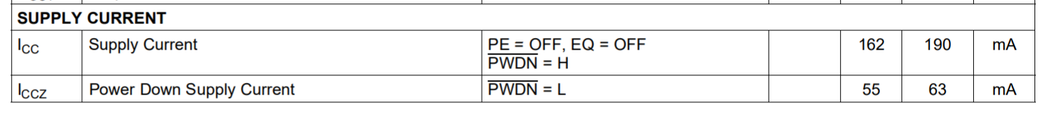

Hi Team,
The datasheet only tells the supply current when PE=OFF and EQ=OFF, what's the supply current when PE=ON and EQ=ON?
Thanks and Best Regards!
Hao

With PE = ON the supply current will increase by ~ 33mA. Turning the EQ = ON will not increase the current any higher.
Lee
