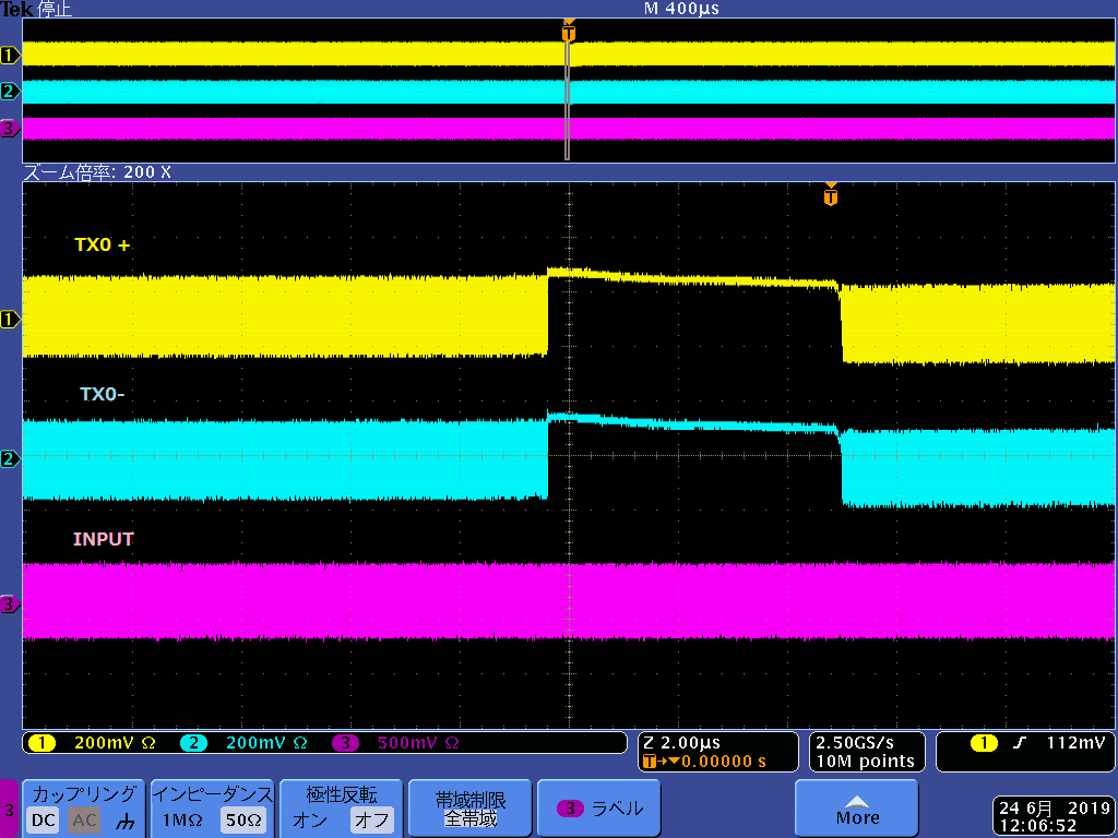

However, I faced a problem.
The DS110DF410 output was intermittently muted for about 5 us.
This occurred several times in about 10 ms.
Please help me resolving this problem

    Q2). When we ran above script and applied 3G-SDI signal, we observed output signal muting for 5us in every 15ms. Why does this happen ?

    The DS110DF410 output port was periodically disables for about 5 us.
    The interval of the disable was 1.5 ms but validated depending on
    Please check the DS110DF410 output using EVM.

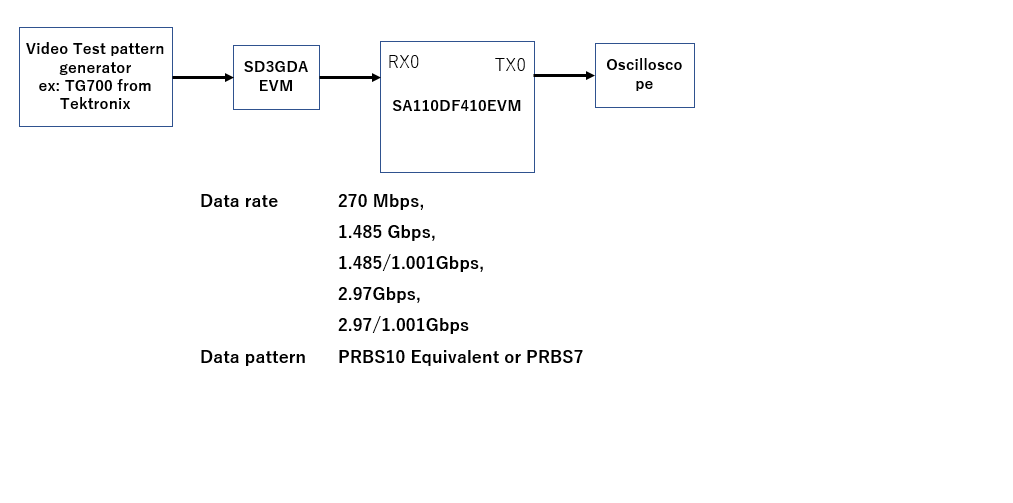

  • I need the question below to be addressed in order to be able to provide any advice.
    • What is the specific data rate and test pattern being used by customer when issue is observed?
    In addition, a system block diagram would be useful here. In particular, Is the customer implementing AC coupling caps on the retimer inputs and outputs?
    Rodrigo Natal
    HSSC Applications Engineer
  • Rodorigo-san
    I sued color bar and tested at SD, HD and 3G.
    All cases I see this symptom
    Mita
      • As noted above, based on our test, we observed exact the same symptom with customer using PRBS-7 pattern at 3.00Gbps.
      • Customer is using SDI signal and we understand that SDI video data (pathological) are not tested or guaranteed, however, since the symptom is observed with the PRBS-7 pattern it seems to be that it is not the SDI pattern issue.
    • In addition, a system block diagram would be useful here. In particular, Is the customer implementing AC coupling caps on the retimer inputs and outputs?
      • Customer is using 4.7uF cap for AC coupling.
      • In our test, we use the DS110DF410EVM with PRBS-7 test pattern. AC coupling caps are 0.22uF (default). Cable length are 0.5m.
        Signal Generator ========||==DS110DF410EVM==||========Oscilloscope
        • If you see the waveform in wide time range it seems like it has correct signal output, however, you could see the periodical output mute when you zoom in.
        • Typically the device is used at 10GbE, so the CDR data rate setting is used at default. No change when using in repeater mode.
    We had tested force signal detect, however, this did not improve this problem.
    Kawai
  • Rodrigo-san,
    Please see bellow for my test set up.
    Setting bit 7 in address 0x14 did not fix the problem.
    I found that DS110DF111 periodically disable output when the CDR in the device did not got lock.
    Please let me know how to stop CDR state machine.
    Mita
