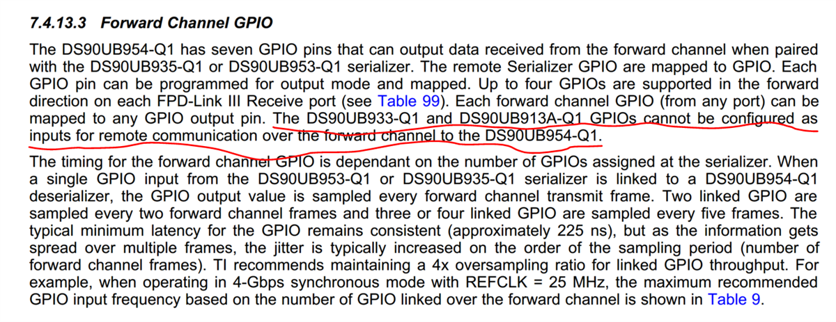

         Is it possbile that 954's GPIOs can be controlled by remote serializer such as 933? just like 954 can set BC_GPIO_CTLx registers to controll 933's GPIO.

             After reading the datasheet for details, I found that it seems 933 is not able to do such control as showing:
               Does that means if we want to using serializer to control 954's GPIO, the only choice is changing remote serializer to 935 or 953?

    My apologies, I thought you were talking about 933 toggling 954's GPIOs with forward channel I2C access. You are correct that they can't be directly mapped over the forward channel between 933/954. If you want to map a forward channel GPIO like that then you would need to use 935/953.
