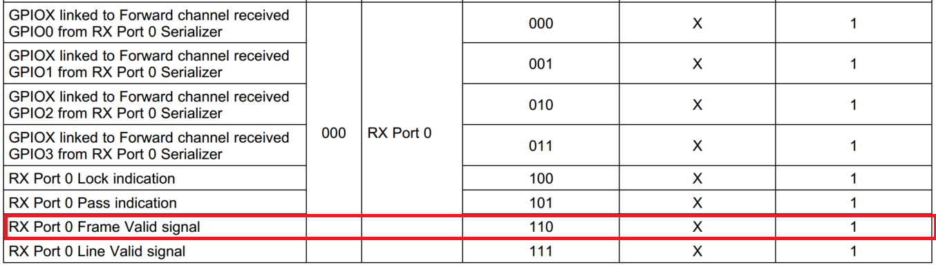

           As 954 datasheet shows that GPIO can be configured as output and linked to port frame valid signal:
         So I set one of 954's GPIO as "RX Port 0 Frame Valid signal" mode(b00011001), and using oscilloscope to measure the signal. What I have got is that, when port 0 received a frame, this GPIO will be high, and keep high regardless of other frame.
         According to the datasheet, I would expect that the GPIO will output a pulse signal(high at frame start, low at frame end), but actually it outputs a single high signal(and keep that way) whenever get a frame start.
         Am I misunderstanding the “RX Port 0 Frame Valid siganl” mode? if so, is there any way, that 954's can output signal corresponding to every frame RX Port0 get?

             my seeting now:
             0x0F = 0x7E, //GPIO0 as output
              0x10 = 0x19, //GPIO0 select RX port 0 Frame valid signal
              sensor is connected to port0.
    Best regards
  • Hello Xingzhu,
    It looks like you have the GPIO0_OUT_SEL and GPIO0_OUT_SRC bits flip flopped. Bits [7:5] should be GPIOX_OUT_SEL which is 110 for frame valid. Bits [4:2] are GPIO0_OUT_SRC which is 000 for RX0. So in total the register should be:
    11000001 = 0xC1

        You are right, the problem is caused by my wrong setting for GPIO0.
         Changed the setting and it works fine.
