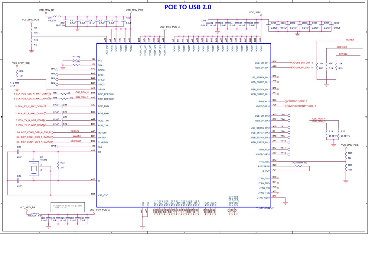

We are using the following design to interface TUSB7320 in our board.
We have ensured that all the power up sequences are followed correctly. Also the 3.3V is enabled after 1.2V. But the WAKE# pin always in HIGH state and we couldn't able to establish PCI link. Are we missing anything in the design? Kindly help us to resolve this issue.
Koil Arul Raj.S
  • The TUSB7340 would have to be configured before it would drive a wake event.  Can you confirm the timing of the resets and why there are pulldowns on the clocks?

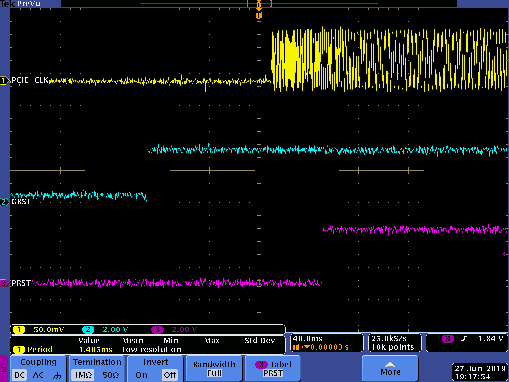

  • Hi JMMN,
    Thanks for your response.
    The GRST pin is set high and OSC_CLK is enabled as soon as power to the PCIE block ON. As per code, the PRST signal is set HIGH, approximately 1.2ms after PCIE_CLK is enabled. Following figure displays the power up sequence order of important signals.
    Regarding the pull down on clock lines, It is done to satisfy the design recommendation of the processor used in our board. Do you find any discrepancy in our configuration and design. Kindly help us to rectify the issues.

  • The clocks look valid, can you confirm the GRST timing meets the requirements listed in Section 9.1.1 of the datasheet?
