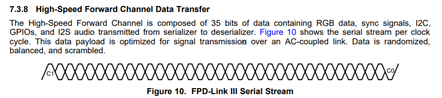

    2, What do C0 and C1 represent in the graph below? How are RGB, IIC, sync signal, GPIO and IIS arranged in 35Bit date of Forward channel? Meanwhile, how are the IIC, CRC, 4 bits of standard in back channel arranged?

    2. The d/s just gives you the p->s signal which includes 35bits per serial stream. For RGB888, which is embedded into these 35bits, also the I2C/I2S/GPIO are mapped into these 35bits as well. C0/C1 is used for control, this is on FPD-Link protocol, it doesn't impact your RGB signals transmission.
