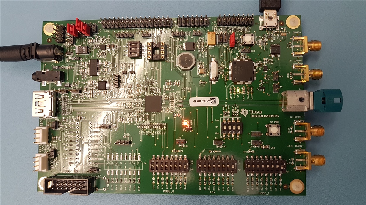

Hi support team,
I am having issues connecting Serializer (DS90UB949-EVM) to Analog LaunchPAD. Software doesn’t recognize serializer profile. However, the message on the footage, ALP Framework - says “Hardware Connected”. I have followed steps for troubleshooting suggested in User’s Guide (Pages 21 – 25) by manually selecting the right profile, still not working.
I have added some pictures to help you understand my setup. Let me know if I have missed anything.
My goal is to establish communication between Serializer (DS90UB949 – Evaluation Board) and Deserializer DS90UH498 (a personalise board).
As rule of thumb, I am checking one thing at the time – starting with Serializer (DS90UB949-EVM), where I fund this issue.
Hardware setup:
1 – the Evaluation board B949 Jumpers were left as default (see pictures)
2 – The MODE_Sel 0,1 straps were left was default

    Thanks for sharing a photo of your board setup. We have seen ALP connection issues when board power or jumper settings is not proper.  It looks to me none of the jumpers are configured to default as defined in the user guide. Please see
    Could you make sure the jumpers and switch settings are as above and try again? Sorry if you had received the board without proper (default) jumper settings from our store.
    Vishy
  • Hi Vishy,
    Thank you for your reply, it did help a lot.
    I have double checked the Jumpers position I have found that J37 was placed way round.
    Now I can get communication with Serializer and Deserializer  as expected.
    Great job :-)!
    Many thanks.
  • Great! Thanks for confirming you got the communication going. I will close this ticket.
    Vishy

    My ALP still reporting unexpected Deserializer serial number; it is reporting Des_926 steady of Des_948.
    Please find details of my current setup below and results of some measurement I have taken from the configuration pins. Note that at this stage I have not connected display yet as I am just trying to get communication between the Serializer and Deserializer.
    Serializer configuration:
    IDX: S3.1 = High   |   (expected address: 0x18)
    Mode_Sel_0: S2.1 = High
    Mode_Sel_1: S6.4 = High
    Dacar 535 4-Core: Coax cable
    What is Map_Sel [0:1] is used for? Can you please comment of your interpretation?
    Deserializer (customized board) configuration:
    IDX: R1 = Open, R2 = 10K |   (expected 8-bit address: 0x58)
    Mode_Sel_0: R1 = Open, R2 = 10k (Dual OLDI output)
    Mode_Sel_1: R1 = 59k, R2 = 24.9k (20Mbps, coax cable)
    Deserializer hardware check:
    There are all supplied voltages: 1.2V and 3.3V
    PLL Lock = 0 (unlocked)
    PASS = 0 (Error condition)
    PDB = 1 (Powered ON)
    BISTC/INTB = 0 (BIST mode disable)
    BISTEN = 0 (Normal Op)
    Setup images:
    The result from the ALP:
    Remote register:
    Please could you review my setup and let me know if I am missing anything?
    Initially, I was thinking the problem was coming from the Deserializer. But now that I have check pretty much everything in the Deserializer side.
    Do you think is there any change that the Serializer Evaluation board (SW or HD) would not be configured properly and therefore it is reporting wrong Deserializer serial number?
    Your help will be very much appreciated.
    Dilson
  • Dilson,
    You mention above PLL lock = 0 (unlocked). If lock is not there, then ALP cannot read remote registers. Remote registers are read through the back channel which can function only after a valid lock.
    So we have to debug why valid lock is not getting established.
    When ALP detects no valid lock, it puts out 926 as the default partner device and you see all 0s for remote registers.
    I looked at your 949 EVM jumper settings. It looks to me some jumpers which need to be set by default are not set. Please correct me if I am wrong
    J14 (RES0 pin of device must be tied to gnd)
    J18 (RES1 pin of device must be tied to gnd)
    There might be a few more.  Please check.
    Vishy
  • Hi Vishy,
    Thank you very much for your reply.
    With your recommendation, I have corrected all the jumpers on the 949 EVM according to datasheet section (1.8 Default Jumper Setting).
    In the Des_948, I still reading PLL LOCK = 0V, PASS = 0V.
    I have attached photo with my Jumpers setting.
    Is there anything else that you would recommend to bring those pins to expected voltages?
    Thanks for your support.
    Dilson
  • Dilson,
    You have the following
    Mode_Sel_1 is S6.4 which means Coax and remote edid load.From the photo, I see you are actually using the STP connector. Suggest you set this as default = S6.1 position which means STP and no edid.
    On the deserializer side also, set resistor network for Mode_Sel1 as STP. with 5Mbps back channel. You can refer our 948EVM user manual Table 1-10 and the schematic. http://www.ti.com/lit/ug/snlu165/snlu165.pdf
    Please try and let us know.
    Vishy
  • Hi Vishy,
    Thank you for your suggestion.
    I have applied the changes you have recommended; for Serializer EVM Mode_Sel1_1 I have selected S6.1 and for Deserializer Mode_Sel_1 I have choose resistors, R1= open and R2=10K (to match default setting).
    Results: I have read voltages from LOCK and  PASS of the deserializer pins both are reading 0V and the ALP is showing default deserializer.
    Is there anything else you would recommend?
    Dilson
  • Some suggestions:
    a) Please review your 948 custom board against 948EVM schematic. I think I shared before the link to 948EVM user guide. It should have schematic and layout. Also, please check your layout against recommendations in DS and user guide.
    b) Suggest you connect wires to the I2C pins of 948 and connect ALP to 948. You would need USB2ANY or Aardvark dongle for this. This way you can check if device is alive and responding to register read/writes.
    c) Please post your 948 schematic (if it is not confidential) so I can also review.
    Vishy
