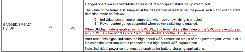

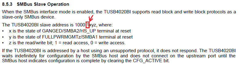

Hi Team,
The datasheet shows GANGED/SMBA2/HS_UP pin sets the value of the SMBus slave address bit 2 when SMBus mode is enabled.
So, I believe "SMBus slave address bits 2 and 3 are always 1 for the TUSB4020BI." is typo and "SMBus slave address bits 3 are always 1 for the TUSB4020BI." is correct.
Is my understanding correct?
