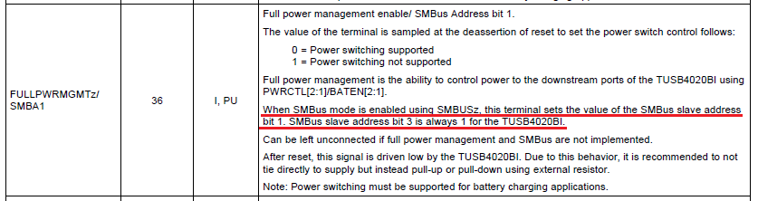

TUSB4020BI: FULLPWRMGMTz/SMBA1 pin
Guru 29720 points
Part Number: TUSB4020BI
Hi Team,
My customer wants to use SMBus mode and the datasheet shows the following about FULLPWRMGMTz/SMBA1 pin.
I understand FULLPWRMGMTz/SMBA1 pin should be set high to set "SMBus slave address bit1 = 1".
However "Power switching not supported" in this case.
If my customer wants to set "Power switching supported", should he overwrite fullPwrMgmtz bit by an SMBus host after power-on reset?
