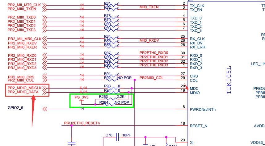

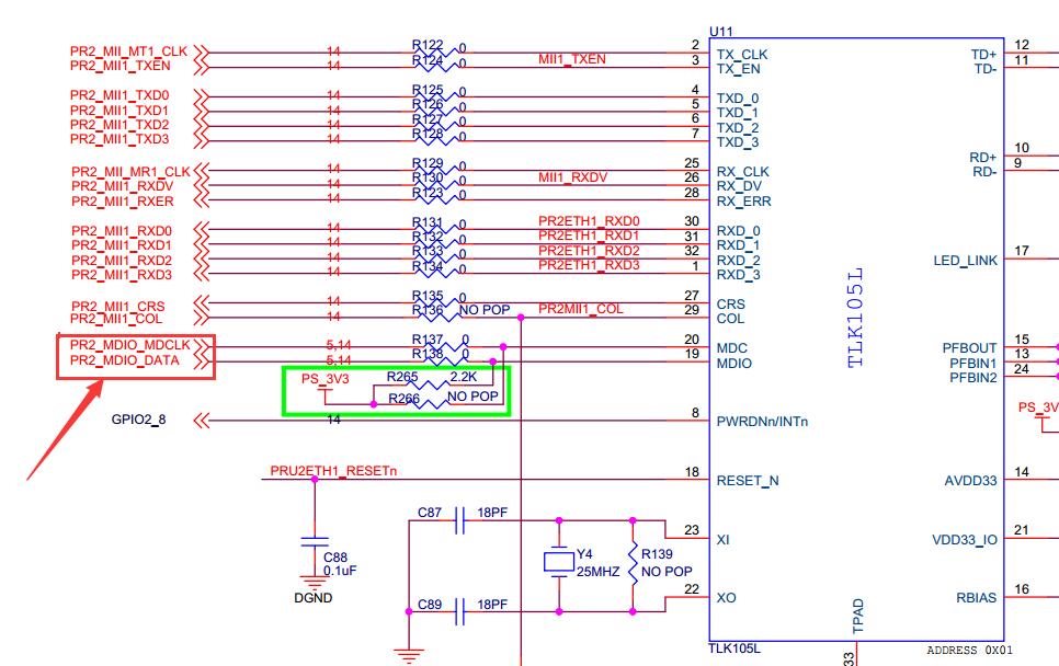

notice: Eth3 plugs and unplugs the network cable, but no Link up information is printed。  Two phy chips use the same MDIO control signal
Why does eth2 work and eth3 not print the Link up information? Is it related to the firmware?

    I am referring to the arch/arm/boot/ DTS /am57xx-idk-common.dtsi file。But eth3 can't get the IP。
    Has PRU ETH of SDK5.3 been tried to use on IDK board?  Has anyone had the same problem?
