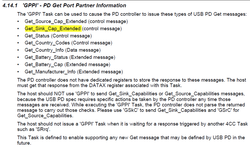

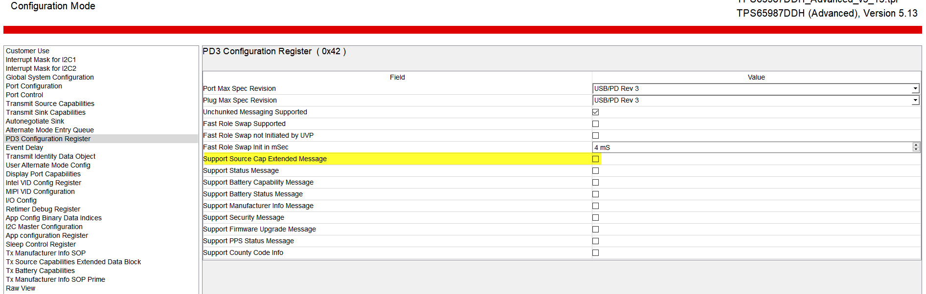

Regarding "Get_Sink_Cap_Extended mentioned in the PD standard, are we able to send this command or respond this command?  What registers should be configured to support this?

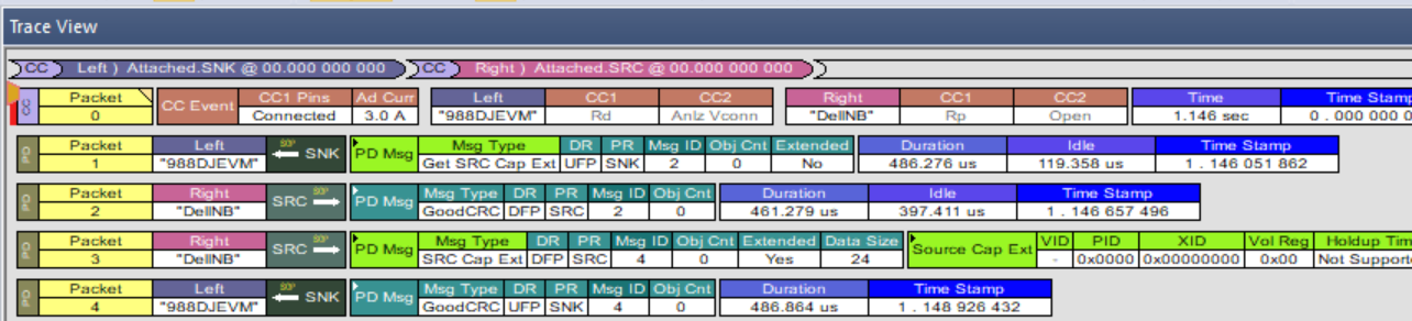

If we're able to respond "Get_Sink_Cap_Extended", would we respond it as the 21 byte SKEDB content defined in PD standard?  Is there any way to test on our EVM to capture CC log for checking how we respond "Get_Sink_Cap_Extended"
