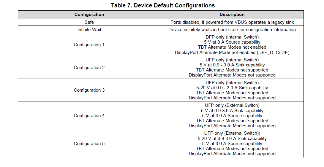

    Regarding the external flash and power duo implementation... All I really want is a 5V/9V USB PD compliant charging port that's cost conscious.  I didn't want to make my client pay for the EEPROMS, but they're cheap so this probably isn't a big deal... That said I also didn't want to charge them time to manipulate the configuration tool and come up with a custom app.... Do you recommend the 'easy' button is to use what you've already done with power duo source or is it easy enough to use the config tool and abandon the external EEPROM?  What I'm getting at is - would you expect a user needs to spend significant time in the config tool?  If the answer is yes, it can take a few days or more to set up the config and successfully flash the 65987D, then it probably makes more sense for me to just include the EEPROM for now and avoid a software task.  If making a custom configuration, flashing it and verifying it only takes a few hours then I'd prefer to abandon the EEPROM to lower the BOM cost.
    - Are there other drawbacks to running without the EEPROM as a USB PD source?

  • The power duo functionality of changing the source/sink capabilities advertised is triggered on a rising edge. SO holding them low should be fine. However, I would not leave them floating as the PD controller could detect this as a transition if it floats to a certain threshold. The best thing to do is disable those GPIO's that you are not planning on using.
    We do not have any default configurations that advertise only 5V/9V, as well as implements the power duo app config so you will need to implement an external EEPROM. Both the power duo source and sink EVMs have their own external EEPROM. If your customer doesn't wish to use an EEPROM, then you can use one of the following default configurations, but none of them seem to line up with what you are wanting to accomplish.
