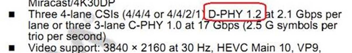

MIPI interface was D-PHY1.2 in SOC side and sn65dphy440ss Re-timer was D-PHY1.1 .
My customer application was 1080p 30 frame video streaming by using 5M camera .
As I know D-PHY1.2 & D-PHY1.1 was Data rate increase , was it suitable to choose sn65dphy440ss for this application for D-PHY 1.2 ?
