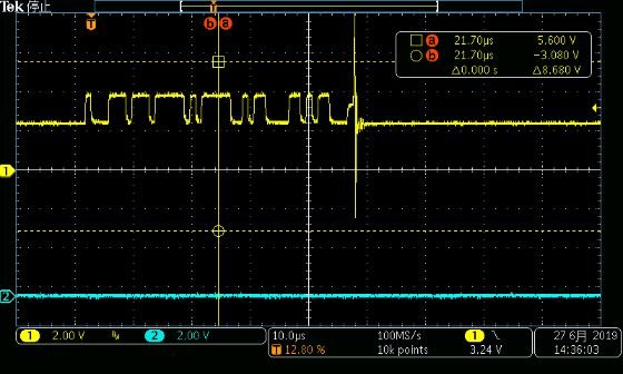

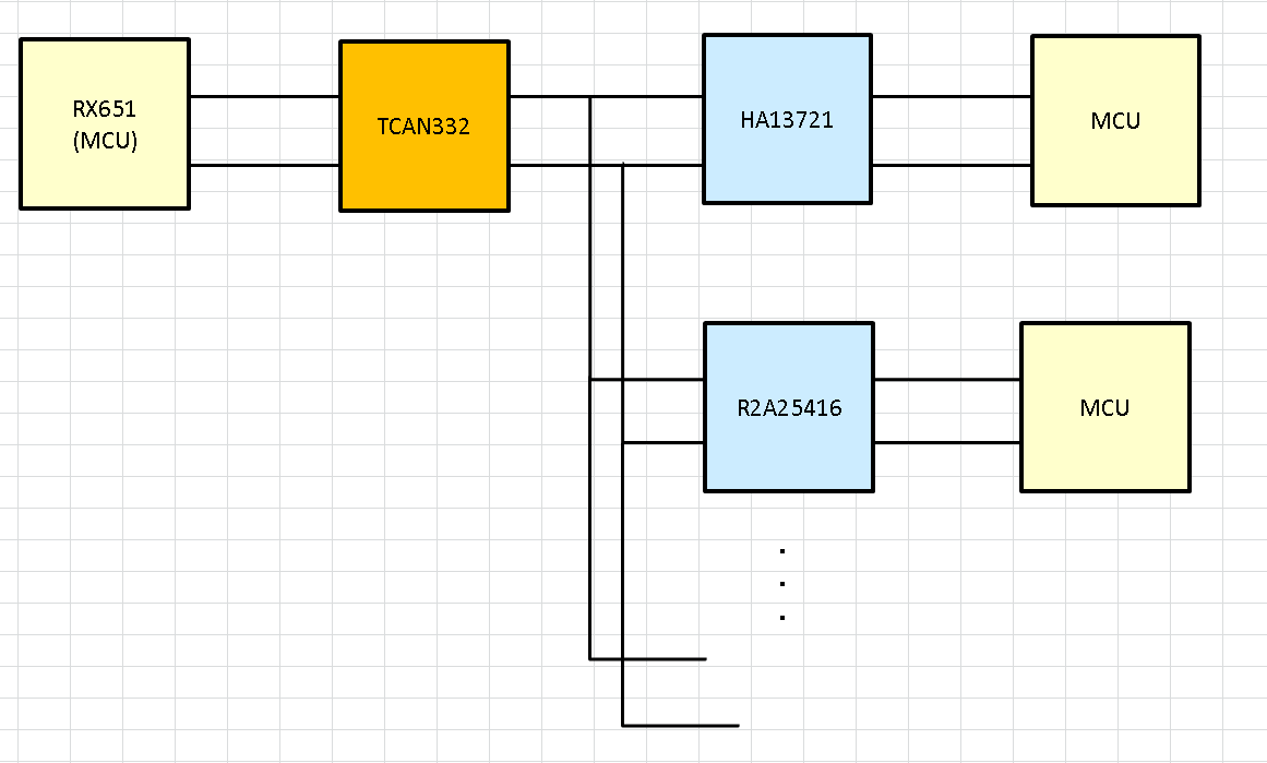

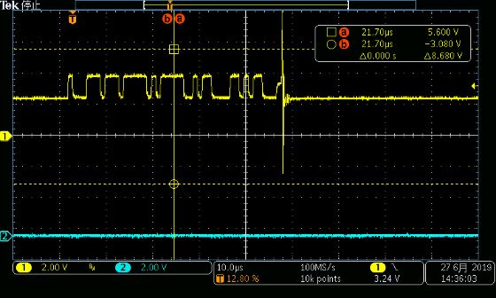

I'm evaluatingTCAN332DCN in a mixed 3.3V and 5V CAN system .
I use 5V CAN IC that HA13721 or R2A25416 etc.
I use single termination.
Probing CANH with an oscilloscope , CANH has large linging at end.
I assumed that I could 3.3V CAN can mix in 5V CAN system , but dose it have any restrictions?
For example node amount,bus length...
I post measured waveform and block diagram.

    I haven't seen an issue like the one you show in the scope shot.  Do you know which transceiver is driving the bit pattern shown?  Is it a 5V CAN transceiver or a 3V CAN transceiver?

    Explain scope shot , this waveform drived by 5V CAN tranceiver probably.
    we want to use CAN with 3.3V MCU and reduce power consumption . This is a request for products that to be made from now on.
    but we want connect 5V CAN module (legacy product) too.
    Which IC should I use?

    The 3.3V CAN and 5V CAN transceivers may operate without communication issue on the same bus network.  The transceivers that you have chosen should operate together. The drawback to mixing 3.3V and 5V CAN networks is that the recessive levels will not be the same reference, and you may see more noise on the common-mode.  But if your application allows it, 3.3V CAN certainly may provide lower power consumption.  And it doesn't look like the issue in these signals is related to common-mode noise.
    I am wondering if this signal behavior is due to an over-voltage stress or small ESD event.  Can you provide some more information about the application and environment in which these transceivers are operating?  Do you see this issue on every CAN transmission?  Is it repetitive behavior, or inconsistent?

    A certain combination is a normal communication waveform, but a certain combination produces an abnormal communication waveform.
    This is a reproducible result.
    Therefore, I decided to shift to the examination of TCAN1042.
