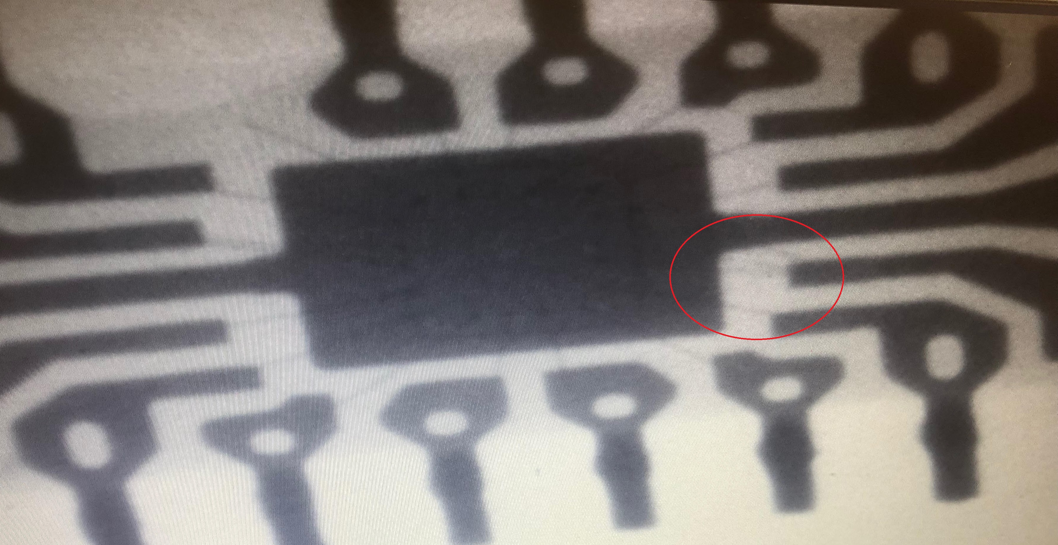

Original details: We have several field failures where input pins 1 and 7 of the DS34C87TM/NOPB were damaged. They are driven from a +5V 74HC32 IC. The inputs work with a +5V signal but when the CMOS gate tries to pull low, the input to DS34C87TM only allows it to drop to about 1.2 volts. Does this indicate ESD damage to the input pins? Surrounding ICs (including the 74HC32) are not damaged. Any ideas of conditions that could cause this failure will be appreciated. Replacing the DS34C87TM/NOPB solves the problem.

    I'm not sure if it's a ESD damage. But it looks like the pin is no longer a high impedance. You can confirm this by measuring how much current is drawn from DS34C87T when the input is around 1.2V? Can you contact TI quality team to submit the parts for the failure analysis? Knowing what went wrong in IC could help identity the cause.

    Thank you for your response. We are working with our distributor (Arrow) to return the parts for evaluation. We filled out the return paperwork from Arrow but are haven't received authorization to return the parts yet. Can you provide any guidance regarding how long it will take for TI to evaluate the parts after they are received?
    Below is an X-Ray of a failed DS34C87T part. The circled area is thought to be a damaged wire bond.
    Any guidance you can provide will be appreciated.

  • Dave,
    Once the parts are returned to TI the Failure Analysis may take up to 14-20 days to complete, or possibly more depending on the complexity of the issue.
    As the quality team checked, they haven’t seen this return entered into TI system yet. So I assume it is still being processed on Arrow’s side. Can you push them to expediate it?
