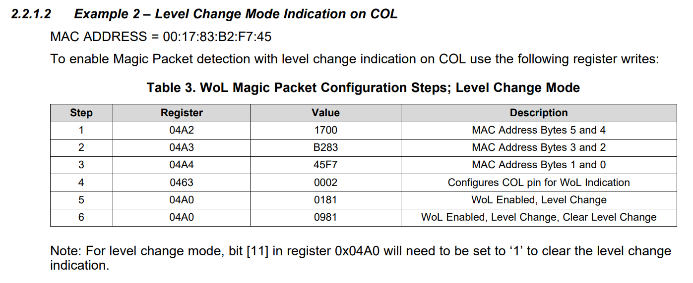

  • For WoL, if we configure below.
    Does it mean that If PHY receive magic packet, COL voltage will change from high to low(falling edge) or low to high (rising edge).
    So we should configure the backend equipment (such as a processor) to be able to wake up through a rising or falling edge on a GPIO and connect this GPIO to COL pin?
    And for STEP6 below, why we need to clear level change? Both 1 to 0 and 0 to 1 is level change, right?
    Yes, the GPIO configured to signal WoL signal changes the level ( the way it is configured). It has to be cleared to know PHY that MAC has interpreted the signal.
